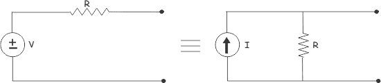

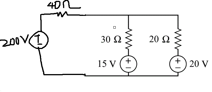

Use source transformation to reduce the circuit to a single voltage source Vs in series with a single resistor R. What are the values of Vs and R?
From this, I can transform the current source to:
I can then find the equivalent resistance to be (30//20)//40 = 9.23 ohms.
However, I am not sure how to find the equivalent voltage in this case?
What should I do to start?
That's a wrong transformation. Read this https://people.clarkson.edu/~jsvoboda/eta/dcWorkout/sourceXfrm.pdf a bunch of examples.

I don't seem to get it, isn't the transformation correct for the left side though?

You have an extra wire that is making a short circuit.
And, by the way, wouldn't you think that transforming the voltage sources instead would be a better strategy?

Ah ok I get what you mean, so something like:
How do I exactly find the 'total' voltage in this case tho?

You use the source transform to make the problem easier. non-ideal voltage sources in parallel are hard. Maybe you could transform the sources into something else?

That is correct, but follow my advice, don't do that transformation.

How do you know between which two points the equivalent resistance is asked? Ditto for "single voltage Vs".
I am not sure if I understood this problem correctly.

The drawing does not make it explicit, but the fact that all of the top endpoints of the devices in the middle merge onto a single wire and that all of the bottom endpoints of the devices in the middle merge onto a single wire strongly suggests that those two wires are the two points between which equivalent resistance is desired.
[I had the same reaction at first]
You would be better served to change the two thevenin sections to norton sections so the whole thing is a bunch of Nortons in parallel.
