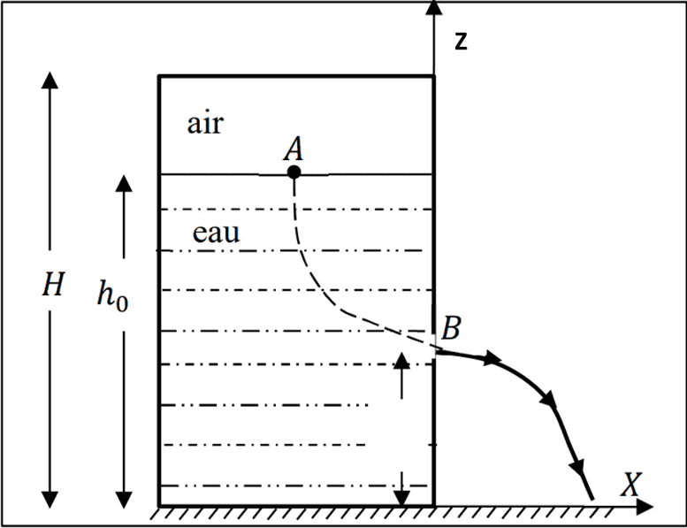

Hello,
Here is my problem: "We have a closed tank of large size which contains a liquid topped by air at a pressure equal to the atmospheric pressure. If the tank is closed, as the water flows out, the volume of air above the free surface increases, so the pressure decreases (law of perfect gases). We seek to find the pressure variation (𝛥P) at the surface of the water in the tank as a function of the z axis (whose origin is at B) and to give the expression of v (the flow velocity) as a function of z."
I know that:
-according to the perfect gas equation P=nRT/V so that pressure is proportional to volume, so that P(t=0)*V(t=0)=P(t=1)*V(t=1)
-That the initial pressure at the surface of the water is P =Patm
-by applying bernoulli between A and B, we have classical V0=sqrt(2gh)
I can imagine the experiment: the pressure at the surface will drop while the tank is emptying (if no air bubbles enter through the evacuation of course, otherwise it restores the pressure atm at the surface). The flow speed decreases as a function of time until the external pressure maintains a liquid level above the drain (thus stopping the flow). I can't put this resonance in mathematical form (𝛥P as a function of z and v as a function of z)
thank you in advance for those who will help me,
Sincerely
here is a simple visualisation of the probleme
Diagram of a tall tank of water with air above the free surface, a height H marked to the top and a water depth h0 marked, with labelled point A at the surface and point B at the outlet, a dashed streamline curving from A down to B and out through a horizontal exit, horizontal dash-dot lines across the water and z and X axes shown.

hello, thank you for your response, Yes you are right I thought that this expression could be true at the very beginning of the draining that's why I called it V0 and I had the feeling that it was there that I had to dig. This homework is actually a problem around which I have to create a practical work. My problem is that I don't know how to develop the expression to solve the problem mathematically

I thought of another solution because I could not use your formula. I think that we can probably assimilate the tank to a tank of right section of constant area S. We can note z=f(t) the height of air in the tank and Zo the initial value. The law of perfect gases applied by considering the temperature as fixed leads to :
Patm.zo=P.z
The velocity of the fluid at the upper free surface of the liquid is (dz/dt).
If we note "s" the cross-sectional area of the outlet orifice, the conservation of flow gives: S.(dz/dt)=s.Vs where Vs is the outlet velocity at the bottom of the tank. Taking into account these two equations, Bernoulli's theorem will give you the differential equation verified by z=f(t). However I can't get to the final equation...

Under that assumption (which also neglects viscosity), let 1 be the upper surface of the fluid, and 2 be the position of the fluid jet.
$$ \frac{P_1}{\gamma} + \frac{v_1^2}{2g} + z_1 = \frac{P_2}{\gamma} + \frac{v_2^2}{2g} + z_2$$
##z_2## is the datum
##P_2## is 0 gage pressure (atmospheric)
## v_1 \ll v_2## the kinetic head in the tank is negligible in comparison to the jet at 2.
##A_1## is the cross section of the tank
##A_2## is the cross section of the jet
##H## is from ##z_2## to the top of the tank
##z_{1_o}## is the initial height of fluid in the tank measured from ##z_2##
$$ \frac{P_1}{\gamma} + z_1 = \frac{v_2^2}{2g} $$
Let the absolute pressure above the tank surface 1 be ##P(z_1) = P_1(z_1) + P_{atm}##
Applying the ideal gas law we are looking for the pressure of the gas as a function of ##z_1##
$$P_{atm} A_1 ( H - z_{1_o}) = P(z_1)A_1( H - z_1)$$
Can you take it from there?
##P_1## will be a function of ##z_1##, and ##v_2## will be a function of ##\dot z_1##.

Based on the figure in post #2, here is my take on this.
Ideal Gas Law: $$P_g(H-h)=P_{atm}(H-h_0)$$where ##P_g## is the absolute pressure of the gas in the head space.
Bernoulli Equation: $$P_g+\rho g h=P_{atm}+\rho g h_B+\frac{1}{2}\rho v^2$$
Combining these two equations gives: $$\frac{1}{2}\rho v^2=\rho g(h-h_B)-\left(\frac{h_0-h}{H-h}\right)p_{atm}$$
Finally, the overall mass balance is $$A_{tank}\frac{dh}{dt}=-A_{exit}v$$
