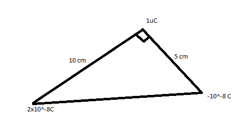

Find Force at 1uC charge
https://i.gyazo.com/12891ce5b3adc422acc64daa6e8d3f25.png
Right triangle with a right angle at the top vertex labelled 1uC. The side from the top vertex to the bottom-left vertex is 10 cm, labelled 2x10^-8C there. The side from the top vertex to the right vertex is 5 cm, labelled -10^-8 C there.
Equation: magnitude of F equals k_e times the absolute value of q1 q2, divided by r squared.
Assume 1uC charge is at point P 2*10^-8C is at A and 10^-8C is at B
FP = FPA + FPB
FPA = K*2*0.01*1/100
= 0.0002*K
= 2k* 10 ^-4
FPA = K*0.01*1/25
= 0.00004*K
= 4K x 10^-4
Now adding them using vector addition,
sqrt((4K*10^-4)^2 + (2K*10^-4)^2 + 0) --(cos(90) will be 0)
sqrt((20K*10^-16)

Your handling of the powers of ten looks off (or you are using nonstandard units for force).
What's 10-6x10-8?
Later, what's (4k10-4)2?
