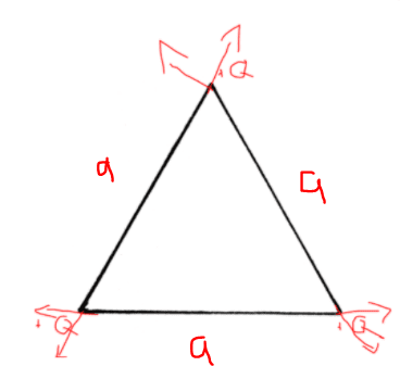

If I try to follow your work, you add three force magnitudes. Can you point them out in your picture ?

There are six arrows in your sketch. How big are they each individually ?
And how do you add them ?
Because they have the same charge I just add each charge -> Q + Q + Q = 3 Q

What is the magnitude of the force that the charge on the lower left exerts on the charge at the top ?
The magnitude will be Q? Now I tried to
BvU said:
Let me try again:
Now I tried to draw the forces into the triangle. The magnitude on the lower left will q or not?
