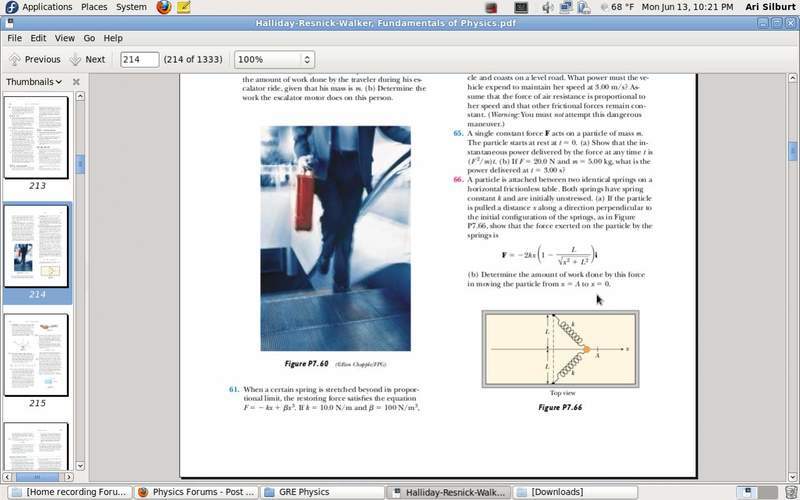

A particle is attached between two identical springs on a
horizontal frictionless table. Both springs have spring
constant k and are initially unstressed. (a) If the particle
is pulled a distance x along a direction perpendicular to
the initial configuration of the springs, as in Figure
P7.66, show that the force exerted on the particle by the
springs is:
F = -2kx(1 - x/(sqrt[x^2 + L^2])
I've attached a printed screen that includes Figure P7.66.
So I know new stretched length is sqrt(x^2 + L^2), forces in y direction cancell, x is multiplied by 2.
New stretched length is L' = sqrt(x^2 + L^2) - L.
F = -kx = -2k[sqrt(x^2 + L^2) - L].
Now here's where I get stuck. It seems like to get the right answer, I need to multiply this by a factor of x/sqrt(x^2 + L^2)...why?
Thanks,
Ari
  • Figure P7.66: top view of a horizontal table with a particle between two springs of length L, displaced sideways by x along the axis labeled x.

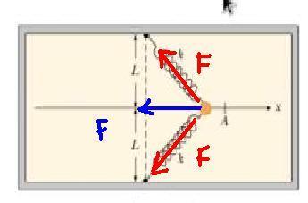

Until now, you have done a good job.
Now, look at the solution. The result is a vector force. It's a component of a red force in my photo, i.e. that is a horizontal component of a spring force.
  • Diagram of a particle attached to two springs in a horizontal box, with the springs stretched to positions L above and below the x-axis; red arrows labelled F show spring forces along each spring, and a blue arrow labelled F points left along the axis.
Alright, I understand that it's only a horizontal component that survives, so is this x/sqrt(x^2 + L^2) like a unit vector thing (vector/length)? If so, what context of the question tells you "oh, I should replace this unit vector with vector/length, instead of keeping it as is..". If this is not a unit vector thing still not sure where this extra term is coming from.
F = -kx = -k[[itex]\sqrt{x^{2}+L^{2}}[/itex] - L]--->Force of one spring
[itex]\sqrt{x^{2}+L^{2}}[/itex]-->stretched length of a spring
[itex]\frac{x}{\sqrt{x^{2}+L^{2}}}[/itex]--->cosine between x and stretched length
-k[[itex]\sqrt{x^{2}+L^{2}}[/itex] - L] * [itex]\frac{x}{\sqrt{x^{2}+L^{2}}}[/itex] i.e.
-kx[[itex]\sqrt{x^{2}+L^{2}}[/itex] - L] * [itex]\frac{1}{\sqrt{x^{2}+L^{2}}}[/itex] --->force of one spring
Ahh, of course. I figured just slapping an i hat on was sufficient. I should have realized it was still involving both x and y until a cosine is taken. Thanks a lot method_man.
