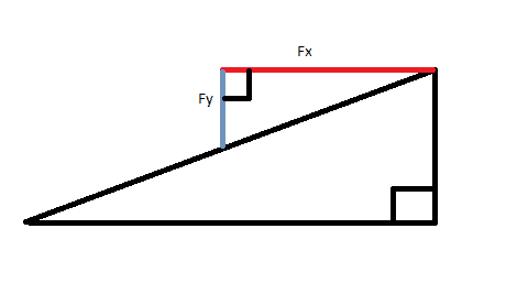

in fact it is this first step where I'm unclear. i can't apply a square coordinate system, since the movement is circular. but winging it, if i set (90 degrees/ x)=(565/188.3), i get x = 30 degrees. is that close?
Here, I attached an image. Can you apply similar triangles and go from here? Remember, the resultant of the forces components points towards the center of the circle; hence, along the hypotenuse of the triangle.
i gather both components will have negative direction then? sorry, our prof isn't very helpful and he didn't even give us a hint on thinking like this, with triangles. so i got Fnet= (m*v^2/r), and multiplied by cos(30) and sin(30) for the x and y components, respectively, but my answers are marked wrong.
Yes, both vector components will be negative. What answers did you get? Are you positive that your value for velocity is correct?
