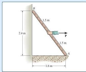

The uniform 30kg ladder rests on the rough floor for which the coefficient of static friction is 0.9 and against the smooth wall at B.
Determine the horizontal force P the man must exert on the ladder in order to cause it to move.
F= friction coefficient* Normal force
equilibrium equations for horizontal and vertical components and moments (torque).
I have attempted the solution but I have no answer to compare with so I am not sure if I am correct or not.

y components: N_a - 300 = 0, thus N_a = 300N
x components: N_b + p - F_a = 0
N_b + p - (0.9*300) = 0
moment at B: 300(1.8) - 300(0.9) - 270 (2.4) + p(1.2) = 0, which gives an answer of 315 for P. which i don't think is right considering the weight force and friction.

Can you tell me have you considered the delta,θ ? And when you want find up the force of x,y components, you should apply cosine and sine. :shy:
umm do you have to? is there a vertical component of P?

The angle is 53.13o
(1)The force of P is plus the force acting on the point B equal to the Friction force.
(2)Therefore,to find up the force acting lie on the wall applied sum of moment of B of direction x = 0:
-3xsin53.13xFB+1.5x300xcos53.13o=0
FB=112.5N
(3)Fp=Ff-FB
ans: Fp=270-112.5=157.5 N
:frown: Sorry ! i have changed it so much times because i have checked it again and again.Actually, you are right but just not think above the angle.
