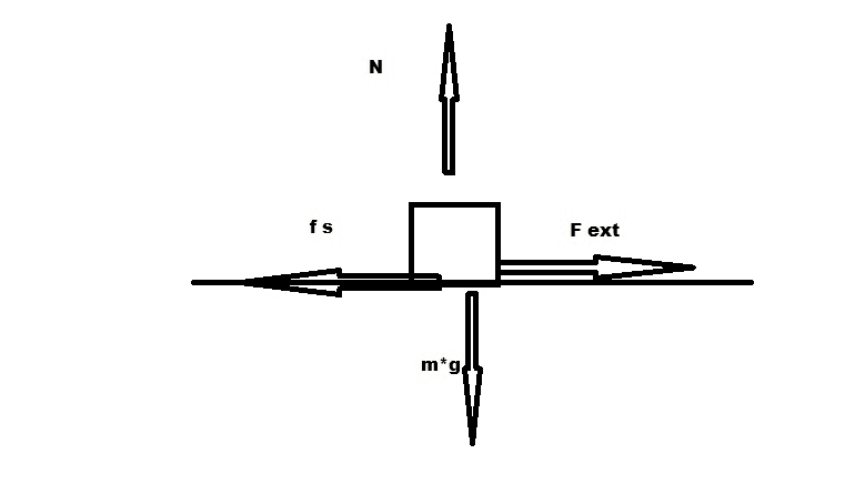

A 1.2 kg block is resting on horizontal surface. The coefficient of static friction between block and
surface is 0.5. What is the magnitude and direction of force of friction on block when magnitude of external force acting of block in the horizontal direction is 9.8 N
fs = μs*N, N = mg
Free-body diagram of a block on a horizontal line, with arrows for normal force N upward, friction f s to the left, external force F ext to the right, and weight m*g downward.
m = 1.2 kg, μs = 0.5, g = 9.8
fs = 0.5*1.2*9.8 N = 5.88 N
Is this really the full problem statement, exactly as presented, because something seems wrong about it.

please tell me what is wrong about it?
If the applied force is less than the normal force times the coefficient of static friction, then the friction force will equal the applied force and the body will not move. If the applied force is equal to the normal force times the coefficient of static friction, then the friction force will equal the applied force and the body will be on the verge of moving. But, in your example, the applied force is greater than the normal force times the coefficient of static friction, so the body will move, and kinetic friction will prevail; in this case, the coefficient of static friction is irrelevant, as is the normal force times the coefficient of static friction.

So can the force of kinetic friction be found? if so how to find
physaru86 said:
S
To find that, you need to know the coefficient of kinetic friction.
