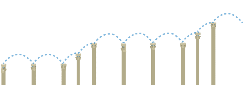

Hello,
I'm new to this forum, and I signed up because I have been struggling with this problem for a couple of days now.
I am making a game where the player has to land on specific platforms.
The player runs at 4 meters / second.
When the player jumps there are 4 different platforms to land on.
All platforms are 50 centimeters apart, each.
1 jump covers a distance of 2 meters. ( Hence the 4 platforms to land on each jump. )
I currently have the following equation to solve the problem:
abs(sin(0.5 * PI * x))
I enter the distance at x. And it returns the correct height.
In theory, this works, but in game I have to keep applying gravity etc.
How could I possible make the player jump this curve when applying gravity?
I have 0 knowledge of physics or whatsoever.
Never had any good math lessons at school so I suck at this topic.
I hope I was clear enough.

Well, the simple answer is you can't make the player follow this curve by following gravity since, as jedishrfu said, projectile motion follows parabolas not sine curves. If you're willing to adapt the game design so that the platforms are along the correct type of curve, we can help you—but if you're sticking with a sine curve, we can't help you with "converting it back to gravity" because that's not what gravity does.
Your sin curve and parabola share a lot of common features so that switching shouldn't be a problem.
The way most game physics works is that they numerically integrate a simple formula to get the parabola. Starting at a given position with a given initial velocity
vx = vx0 * t
vy = vy0 - g * t
x = x0 + vx*t
y= y0 + vy * t

(Don't leave out your units like m or m/s when substituting things into equations, they're important!)
That formula gives you the maximum range of a projectile launched with initial speed v at angle 45 due to gravitational acceleration g. Since you know the maximum range you desire (2m), you've picked 45 degrees as the launch angle, and you seem to be sticking with the acceleration of real gravity that means you have to solve for initial launch speed, ##v_0## (which you wrote as ##v##, but ##v_0## is better since it's just the initial speed).
Now having determined all your projectile parameters, what you want is the equation for the trajectory given here:
##y = \tan(\theta)\cdot x - \frac{g}{2v_0^2\cos^2(\theta)} \cdot x^2##
where y is the height as a function of distance x, ##g=9.8m/s^2##, θ is whatever you chose for the launch angle (45 degrees in your example), and ##v_0## is what you calculated above. By calculating this at x=0.5m, 1m, 1.5m, and 2m, this will tell you how high to put your platforms.
Now I'm assuming your game has a time parameter and so you will want the avatar's position to be a function of time. For this, you want what are called the parametric equations for projectile motion (given right above the trajectory equation in that same link), and they are:
##x(t) = v_0\cos(\theta)t##
##y(t) = v_0\sin(\theta)t - \frac{1}{2}gt^2##
(or you can just calculate x(t) and then plug that into the equation above for y as a function of x).
And that's it! If run into trouble doing this, just ask—but do be specific in your questions so we can help.

I see, so the character will stop on each of the platforms along the way? That changes your scenario quite a bit. If the avatar jumps and lands on the first platform and then makes the exact same jump again (i.e. same initial velocity) it will not continue along the same trajectory as before. It follow the same shape trajectory but from the new starting point.
Here is how the game works:
The character has to jump on these platforms.
He can only tap the phone screen, and the character jumps.
Each platform will play a beat.
Because we want to be able to move the platforms closer to each other, we have to also increase their position on the Y axis.
This way, we are able to catch the player mid air, and the player is able to jump again from that platform.
He is constantly moving at a speed of 4 m/s so you need a pretty high reaction speed to play the game.
But that is what the game is about.
Hope that explains the situation.
I see, that makes sense—so in your original drawing, those were just possible locations of the platforms.
Note, though, if you are requiring a constant horizontal speed of 4m/s then you no longer have the freedom to choose the horizontal velocity in the above equations. The only parameter you would be free to adjust is the strength of gravity (g in those equations) to get the 2m range you want.
Cant you instead adjust the vertical velocity?
As long as he's fine with giving up the 45 degree jumping angle, which their might be aesthetic reasons for. But yes, either the angle or the gravitational acceleration will need to be adjusted if the horizontal speed is to remain fixed.
