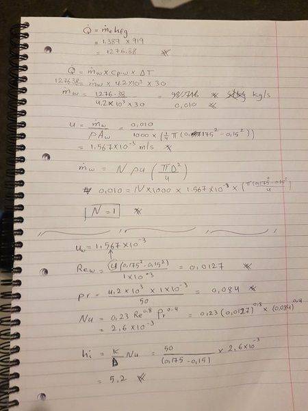

Hi,
I need someone to help me with this question. I tried to find the answer for two weeks I could not finde it. Anyone with the required experience can help! I will be so grateful.
Question:
A shell-and-tube heat exchanger is to act as a condenser: saturated ethyl alcohol (ethanol) vapour at pressure of 1 atm is to be condensed on the shell side and cooling water will be used in the tubes. U-tubes will be used (giving two passes on the tube-side). They will be steel, with a total length (end-to-end of a U-tube) of 6m, 15 mm inside diameter and 17.5 mm outside diameter. Thermal conductivity of steel can be taken as 50 W/m/K.
It is required to condense a maximum vapour flow of 5000 kg/h with no sub-cooling of the condensate. Cooling water is available with a maximum summer temperature of 25°C and with the temperature-rise (DT) limited to 30°C. A search of the literature shows that a heat transfer coefficient of around 5000 W/m2/K can be expected on the shell side for condensing ethanol. Fouling factors on the inner and outer tube surfaces may be assumed to be 0.0001 m2×K/W and 0.0002 m2×K/W respectively.
Determine the number of tubes required, the overall heat transfer coefficient and the effectiveness of the heat exchanger.
Fluid properties may be evaluated at mean fluid temperature. Other assumptions made must be fully justified.
They are in my attempted solution
My answer is attached as an image[/B]
  • Handwritten calculation on lined notebook paper for a heat exchanger tube-side water flow and inside heat transfer coefficient, including Q = m dot cp dT, velocity 1.567 x 10^-3 m/s, Re, Pr, Nu and h_i = 5.2.

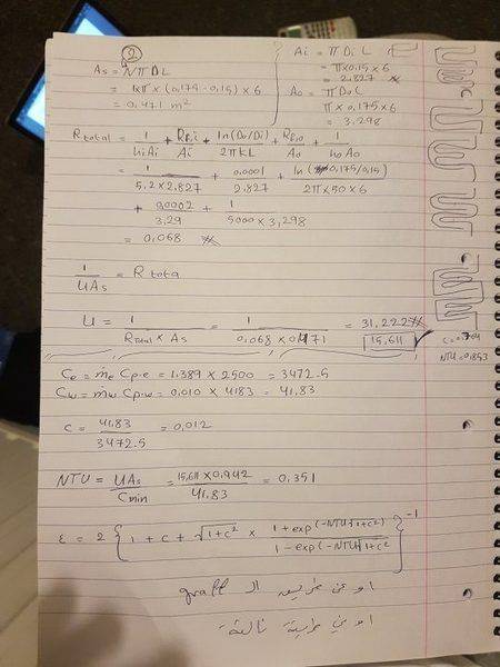

  • Handwritten engineering calculation on lined notebook paper: heat exchanger area and thermal resistance sum giving R total = 0.068, overall U = 31.22 (crossed out, 15.61), heat capacity rates, C = 0.012, NTU = 0.351, and effectiveness formula with Arabic handwritten notes below.

It would help if you added units to your calculations. If you think you can condense more than 1 kg/s of ethanol with 0.01 kg/s of water it must ring all alarm bells...

Yes I know but I have not coz I think my answer is wrong :(. If you have any idea only on how can i get the number of tubs I will be able to solve the rest!
Your heat capacity for water is 1000 x too high. It should be 4.2. Also, I looked up the heat of vaporization of ethanol at its atmospheric boiling point of 78.4 C, and it is 841 kJ/kg.

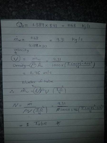

$$\dot{Q}=(1.389)(841)=1168\ kJ/sec$$
$$\dot{w}=\frac{1168}{(4.184)(30)}=9.31\ kg/sec$$
The atmospheric boiling point of ethanol is 78.4 C. Didn't you look that up? How can you get the log-mean temperature difference without knowing the ethanol temperature?

Handwritten calculation on lined paper for number of tubes in a heat exchanger: Q = 1.389 x 841 = 1168 kJ/s, mw = 1168 / (4.184 x 30) = 9.31 kg/s, velocity V = mw / (rho A) = 1.46 m/s, then N = mw / (rho V (pi D^2 / 4)) = 1 tube.
Can You see this is the number of tubes correct?

No. If you didn't take into account the ethanol temperature, you could not have gotten the number of tubes correct. And you didn't even calculate the required heat transfer area.

If the ethanol enters the shell as a saturated vapor at 1 atm., what is its temperature? If it exits the shell as a saturated liquid at the same pressure, how much has its temperature changed? So what is its exit temperature? What is the temperature difference between the water and the ethanol at the water inlet to the heat exchanger? What is the temperature difference between the water and the ethanol at the water exit from the heat exchanger?

The final temperature of the ethanol is the same as the inlet temperature, 78.4 C. Its temperature doesn't change when it condenses at constant pressure.
Getting the number of tubes is going to be a trial-and-error procedure. You are going to have to guess a number of tubes, and then calculate the heat transfer for anyone of the tubes, given the flow rate, heat load, and temperature differences. Start out by assuming, say, 10 tubes. Calculate the Reynolds number for each tube. Calculate the internal Nussult number for each tube. Get the internal heat transfer coefficient. Get the overall heat transfer coefficient. Etc.
