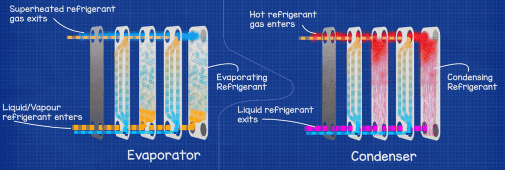

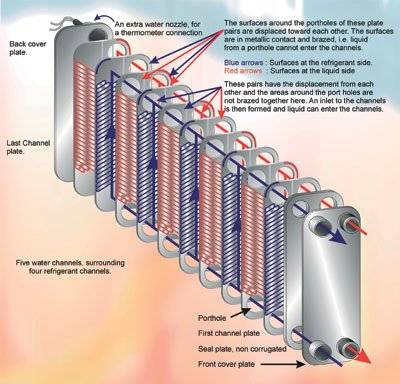

Please see attached below a sample figure for the condenser (on the right-hand side) with plates its shape would be rectangular, and it will be used to condense the refrigerant.
This is basically laminar flow between two parallel plates (neglecting the ends of the high aspect ratio channel). There are definitely going to be analytic solutions in the literature for laminar flow heat transfer between two parallel plates, and the heat transfer coefficients are going to be functions of the channel length. See Bird, Stewart, and Lightfoot, Transport Phenomena, page 431. For a very long channel, where the thermal boundary layer is easily able to penetrate to the center of the channel, the lower bound to the Nussult number is 7.5 (based on twice the channel height, 0.44 cm). For your channel, I don't think that the Nu is going to be much higher than this. But it will depend on the channel length, according to the analytic solution in Bird. Run some numbers on their analytic solution and see what you get. Right now, in my judgment, your estimate of the Nu is high.
