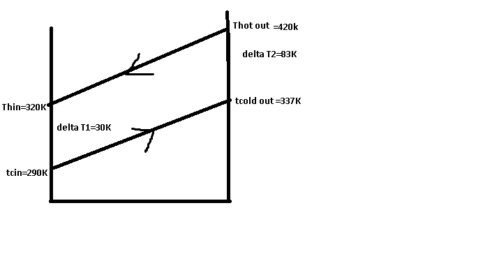

ii)ΔTlm=?(log mean temp)
##ΔTlm=\frac {ΔT1-ΔT2} {ln(ΔT1/ΔT2)}##
Where ΔT1=left hand side temp diff, and ΔT2 is right hand side temp difference.
Oil is on hot side, water on cold side.
Oil:Tin=420K; Tout=320K
Water: tin=290K ,tout=?
##tcout=tcin+\frac{Qhot} {mcold*cpcold}##
##Qhot=m*cp*ΔT=0.24*2000*(420-320)##
##Qhot=48000J##
=>##tcout=290K+\frac{48000} {0.24*4180}##
=>tcout=337.84K
=>ΔT1=320-290k
ΔT1=30K
ΔT2=420-337K
ΔT2=83K
=>##ΔTlm=\frac{30-83} {ln(30/83}##
=>ΔTlm=52K
