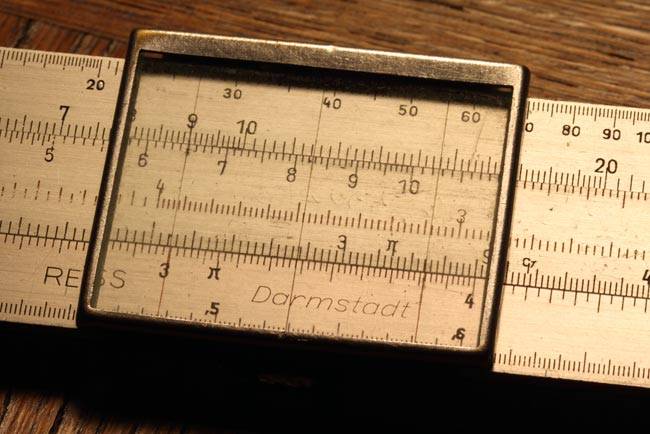

Yes, we used tables or the slide-rulers for the logarithm. I still have my slide ruler and even this time the tables are taught in the secondary schools in my country.
At the College, and later at my first working place, in the sixties, I made the calculations which involved summations and multiplications with an electromechanical calculator. It was very noisy. And I used very heavy 10-digit tables to find sine, cosine, tangent and logarithm.
In English-speaking countries they are called slide rules.
