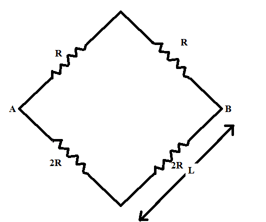

Consider a square whose successive sides of length [itex]L[/itex] has resistances [itex]R, 2R, 2R, R[/itex] respectively. If a potential difference [itex]V[/itex] is applied between the points (call them , say , A and B) where the sides with R and 2R meet. Find the magnetic field [itex]B[/itex] at the center of the square.

The equivalent resistance of this combination is [itex]\frac{4R}{3}[/itex] . So, the current through [itex]R , 2R[/itex] are [itex]\frac{V}{2R} , \frac{V}{4R}[/itex] respectively. But, to calculate the magnetic field, what will be the amperian loop to imagine?
Does the magnetic field pattern have enough symmetry to use Ampere's law? If not, can you think of a different law that you can use?
So, I should use Biot-Savart's law. But another question, can I use Biot-Savart's Law in case of variable electric field?
Yes.
