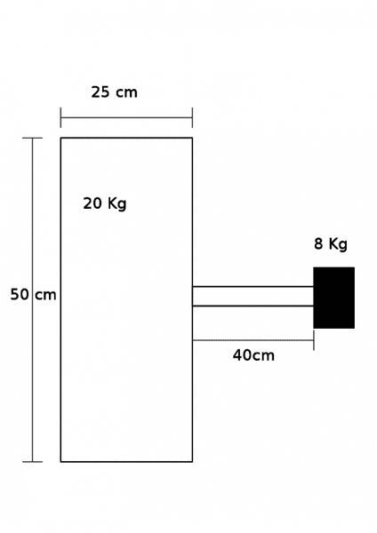

How much weight can an object support on one side, without using counterweights, before falling over?
E.G. a 40 cm arm with an 8 Kg weight is added to a 20 Kg box. Will the box support the weight without tipping to the weighted side?

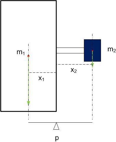

Depends on the size of the box. You want to make a balance about the potential tipping axis.
On the left you have 20 kg x half the length of the box
On the right you have 8 kg x 0.4 m
Half the length applies if the box has uniform mass density (horizontal distance between center of mass and tipping axis -- the lower right)
Make a force diagram to see.
I have made a sketch as example.
So on the lefet you have 20 x 0.125 kg m and on the right 8 x 0.4 kg m. Sum is 0.7 kg m to the right will keel it over !

Nice try, but that case the 8 kg would try to rotate to the right with 8 kg times the horizontal distance of the center of mass of the 8 kg weight to the potential tipping point. Which is not the .125 m if it's an iron weight
So let's make the weight 10 cm long.
(20 x 0.05 kg m) - (8 x 0.05 kg m) = 0.6 kg m. Is it right this time?
Can you then adjust this formula to calculate counterweight needed?
So let's make the weight 10 cm long. (20 x 0.125 kg m) - (8 x 0.1 kg m) = 1.7 kg m. Is it right this time?
It would be (20 x 0.125 kg m) - (8 x 0.05 kg m)
See it as a see-saw or a weighing scale with uneven arms. As long as m1x1 - m2x2 > 0 it won't topple over point P
