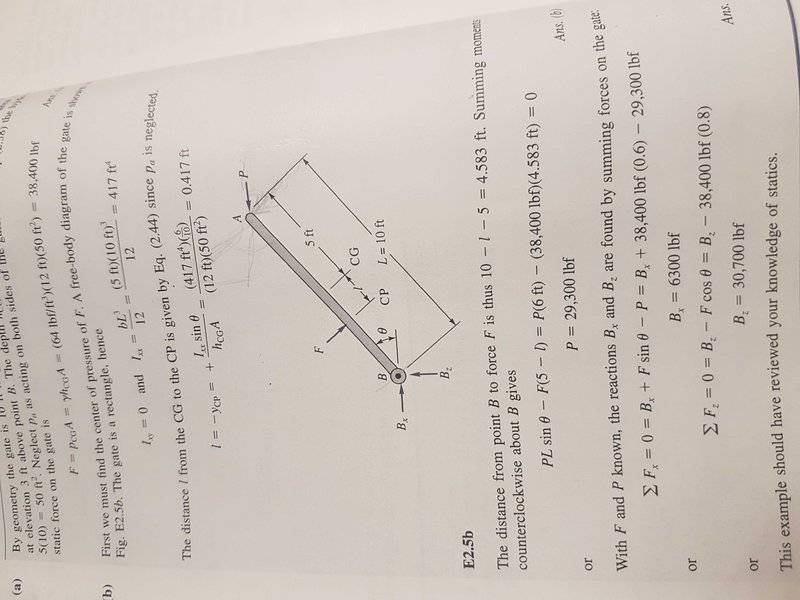

Could someone please explain to me how the moment generated by P is calculated by PLsin@. I understand the length I just can't figure out how it is Psin@. I believe the moment acts opposite to force F but when I build my triangle for trigonometry I'm getting it wrong?

Can you show us your force triangle? When gravity acts vertically on that rod, in which direction is the moment vector on it?
L*sin(theta) is the perpendicular distance (lever arm) of force P about point B. Sin(theta) "acts" on the distance L, not the Force.
Moment = Force ( Cross Product) Distance in 3D
Moment = Force * Perpendicular distance in 2D
