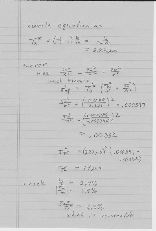

Thank you all for your helpful feedback! The PDF @caz provided was incredibly helpful. However, after calculation, the uncertainty value is still too big. I'm pretty sure I did something wrong, but I'm not sure where to identity what went wrong. For an in-depth explanation on the steps I went through, please refer to the "last" paragraphs (after the dotted lines).

@caz, as mentioned, below is my attempt to obtain the uncertainty value.
For starters, please note the below values that are being used.
##m=-0.008344 \pm 0.0004948## mV/##\mu##s
##b=2.931 \pm 0.07160## mV
##T=222.05 \mu##s (finding for the uncertainty of this value)
Equation used:
$${T_2}^* = \frac{\big(\frac{b}{e} -b \big)}{m}$$
Calculating the uncertainty value:
Starting with ##\frac{b}{e} - b##, I have ...
$$\sigma_b= \sqrt{\big(\frac{0.0716}{e}\big)^2 + (0.0716)^2}$$
Note that I assigned the above value with a variable ##\sigma_b##.
To divide by the uncertainty value of ##m##, I used the equation in the PDF (i.e. ##\frac{{\sigma_x}^2}{x^2} = \frac{{\sigma_u}^2}{u^2} + \frac{{\sigma_v}^2}{v^2}##) as shown below:
$$\frac{{\sigma_{{T_2}^*}}^2}{{{T_2}^*}^2} = \frac{{\sigma_b}^2}{b^2} + \frac{{\sigma_m}^2}{m^2}$$
Numerically, it would look like the below equation.
$$\frac{{\sigma_{{T_2}^*}}^2}{222.05} = \frac{\sqrt{\big(\frac{0.0716}{e}\big)^2 + (0.0716)^2}}{(2.931)^2} + \frac{(0.008344)^2}{(0.0004948)^2} = 251.2909 ... $$
Obviously, something went wrong in my above calculation. My biggest concern would be ##\sigma_b##, though I am not certain where or how to rectify the problem. Any additional help on this would be greatly appreciated.
Once again, thank you all very much for your helpful feedback and explanations.
I haven't checked your initial equation.
You made a couple of mistakes in the error propagation.
You used ##\frac{m^2}{{\sigma_m}^2}##
and you also used the error for ##{\big(\frac{b}{e} -b \big)}## in the numerator but the value for b in the denominator.
I've attached my calculation.
Notice at the end, I am checking percent error. The basic idea is that experimental error is random (not systematic); therefore the probability that maximal error is occurring for both variables at the same time is small so the percent error of the result should be smaller than the sum of the percent errors of each of the components. Notice that the error formula is essentially a function of percent errors in this case.

@caz , thank you so much for your help!
In retrospect, I should have factored ##\frac{b}{e} - b## to ##\big(\frac{1}{e}-1\big)b## (as you have demonstrated) to make applying the equation of error propagation a much more streamlined process. My mathematical folly aside, thank you very much for providing clarity in the solution process.
