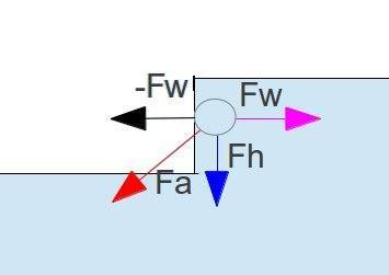

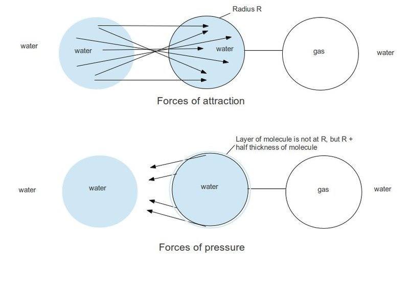

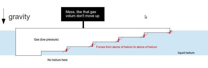

I would like study a theoretical problem. A system composed of 2 spheres can move at left of at right in water. One sphere has gas at low pressure and other sphere has water in it. The wall of spheres are very thin and has the same density of water. Sphere of gas don't has force because it has same water at left and at right. But sphere of water "see" a virtual sphere of water that attract it (because in other direction there is sphere of gas), this force is F1. The pressure must compensate F1 but I don't understand how because pressure is give all around sphere of water and density is not a linear law and angles are not the same (if you change angle, you change distance).
And especially the layer around the sphere of water is not at R but at R more half thickness of molecule. Do you know if this calculation is done somewhere in the net ?

I don't understand your question.
The water-filled sphere with walls that have the density of water is basically an isolated lump of water. Therefore it floats in water at any depth. The buoyancy force is equal to the weight provided the sphere is totally submerged.
The air-filled sphere displaces it's own mass of water. Since this mass of water has a smaller volume than the sphere, the sphere will float with only part of it's volume submerged. If the sphere were totally submerged, then the buoyancy force on it would be the same as the buoyancy force on the water-sphere (provided they were the same volume)... i.e. equal to the weight of water displaced. The difference in behavior is because the buoyancy is not the only force at work here.
I think you will see the situation more easily if you use vertically oriented cylinders instead of spheres. The pressure of the fluid increases with depth - this means the pressure on the bottom of the cylinder is bigger than the pressure on the top creating a net force upwards. This is the buoyancy force.
I also suspect you'll benefit from Donald Simanek's treatment of buoyancy - which is in the context of the quest for perpetual motion (which helps explain the phenomena), making it more fun ;)
http://www.lhup.edu/~dsimanek/museum/themes/buoyant.htm
pmm can be a useful way of demonstrating physics - by counter-example.

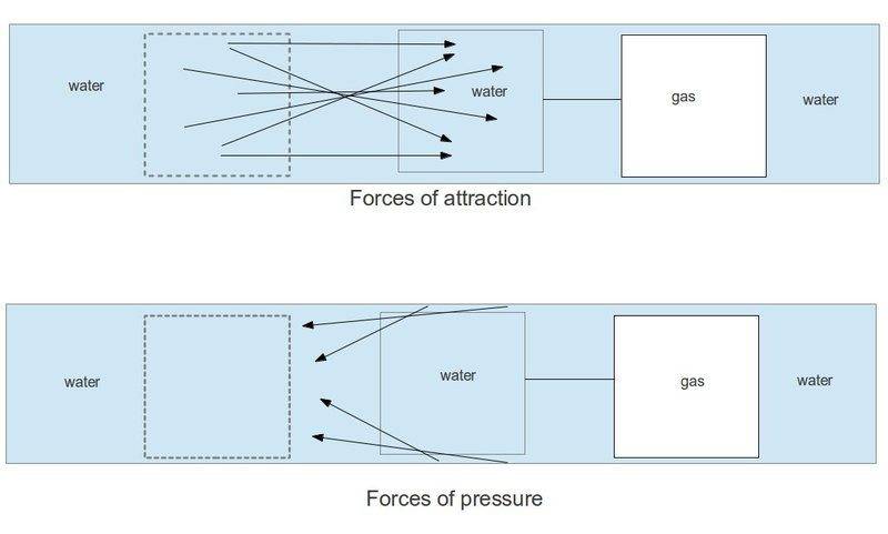

I'm interesting on the difference between attraction and pressure forces. If you let my study on Earth, supposed that gravity is exactly perpendicular to the image, like that it's easy to understand.
1/ Consider the sphere full of water: what are forces on it ? At right, gas attract near nothing in the contrary at left water attract sphere of water. For know the attraction, it's necessary to calculate all forces from one molecule of water at left on all molecules of water at right. Look at angles.
2/ Consider the pressure on sphere of water: what forces on it ? The pressure is given by the sum of all external molecules of the sphere.
Angles are not the same, so the distance not too, so the sum of force must be different (but it is equal), so I forget a force somewhere.
It's easier to calculate with square object like image is showing.

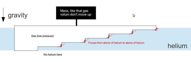

Ok, you accept these forces. So with a shape like that in water, on Earth, red object move alone at left ? Even there is viscosity the lateral force must be 0 (you can replace water by helium).
No, it does not move. We've discussed this exact issue many times.

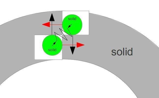

Ok, so in this case red forces don't exist ? Atoms of helium don't attract atoms of helium through volume of gas ? Why ? The volume of gas is asymetric and I don't understand why sum of red forces can be at 0. At right there are red forces, not at left (no helium at bottom). Someone in this world has computed this for test or test in a container of helium ?
What is a "red force"?
In this example, it is easy to see that the surface area facing left and the surface area facing right are equal, so the forces pushing in each direction must be equal.
Also, gas molecules don't attract each other, they repel each other; that's what creates the pressure. Regardless of that, buoyancy works the same in a gas and liquid.

russ_watters said:
What is a "red force"? In this example, it is easy to see that the surface area facing left and the surface area facing right are equal, so the forces pushing in each direction must be equal.
Red force is gravitational force: a mass attract a mass, so an atom of helium must attrack an atom of helium, the force is very small. The surface at right = surface at left, I'm agree. But at left: atoms of helium can't attract atoms of helium through walls of solid.
It's a liquid helium not a gas, low temperature, no friction.

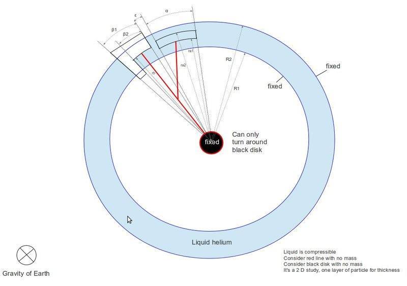

1. We already explained that the gravitational force between helium atoms is insignificant. You should calculate it to prove to yourself it is.
2. In your sketch, the force lines you draw go through the object.
3. The lines are not perpendicular to the object.
Even if one atom attrack one atom, the force can be like 1e-60 N, it's very small, but sum of force must be exactly at 0 and if liquid helium has no viscosity this would say the object can accelerate with this force.
Yes, why not ? the gravitational attraction is direct (line from atom A to atom B), no ? I put gas at low pressure in white object, low pressure that it's possible to have.
Ok, but a part of force is apply to the surface of object (-Fw in vector), object apply a force perpendicular (Fw) to its surface on the atom of helium and a rest of force is for atom of helium (Fh). For me, atom of helium move down and object move at left. What's wrong ?
No - because the sum of all the forces are exactly zero. The very small gravity force means that the other forces are very slightly different from the usual approximation as well.
Did you include every force.
You have to sum all the forces. There are lots of them and if you insist on including every single insignificant force as well all you'll get is a very big summation that still comes to zero.
Gravity should be acting at the center of mass while pressure forces should act perpendicular to the surfaces. Don't forget that every action has an equal and opposite reaction.
Dealing with these sorts of ideas by looking at forces can be confusing.
You should also check your ideas by looking at conservation of energy - if the object were to accelerate, it would gain energy - where did that energy come from? How did it get there?

Am I the only one who thinks that picture in the first post presents a very cool problem? If we assume that there is no external source of gravity, only water, then the g-field is as OP described. It's going to pull the water-filled sphere to the left, away from the air-field sphere. In contrast, there is no net force on the air-field sphere. So the question is why two spheres don't move together to the left.
And, of course, the answer is pressure. The problem is that OP drew that also to the left, but pressure is going to push the water-filled sphere to the right. Why? Because the air-field sphere placed in an infinite pool of water is going to behave like an object with negative mass. It's going to repel all the water around it. And if we take water to be perfectly incompressible, then a pressure gradient will establish to keep all water static. That pressure gradient is going to push on water at every point in this pool towards the air-filled sphere with the force exactly opposing gravity. That includes the water-filled sphere.
So the problem is static, nothing is going to move, obviously. It's just much easier to see if you take air-filled sphere as the center of everything and consider the g-fields from that perspective.
It could be any number of intriguing puzzles depending on how one reads the diagram.
The main trouble is that it is not at all clear what is intended.
Notice how the diagram changes is the wall of the water sphere is made a bit bigger?
Asked to be clearer, OP just changed to a different setup.
The description of the diagram seems pretty clear, once you get over the broken English. The thickness issue comes up only because OP is a bit confused on how the relationship between pressure and buoyancy works.
