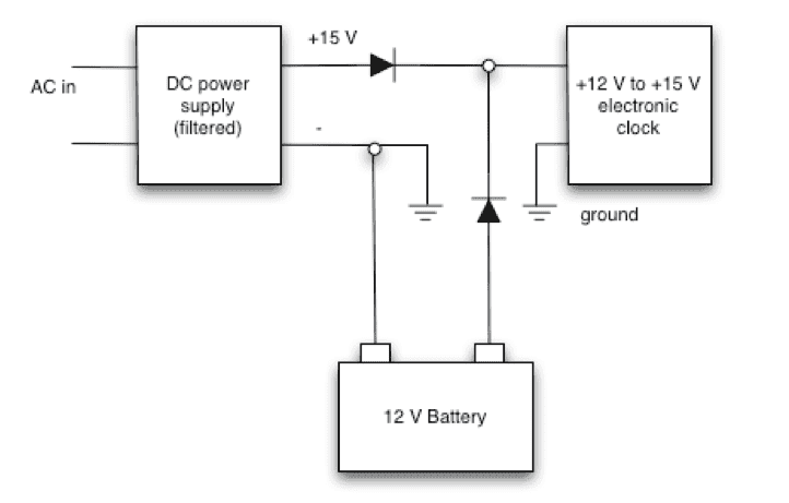

Make a modification so that the battery is charged by the DC supply at a current of 10mA
**See attached diagram**
Well I know that I would put in a resistor in parallel with the diode. However, I don't know how I would solve for the resistance.
I'm assuming that I would use Ohm's law:
V=IR where I=10mA, and I don't know what the voltage drop across the resistor would be... would it be 3V so that the battery drops 12 volts?
Any help would be great!

Yes, that is correct.
thanks for confirming :D
