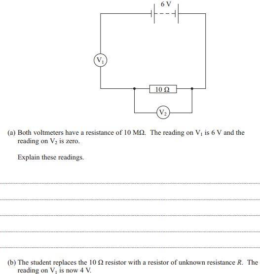

I understand part a, but not part B.
Circuit schematic with a 6 V cell, a voltmeter V1 in series in the left branch, and a 10 Ω resistor in parallel with voltmeter V2 across the lower section.
For part b) the PD across the resistor is 2V, but we don't know the current so we can't calculate using ohm's law eqn.
And because the new resistor's resistance is unkown, how do we actually calculate it?
  • Circuit schematic with a 6 V cell, a voltmeter V1 in series with the cell branch, and a 10 Ω resistor in parallel with voltmeter V2 across the lower branch.
You've not actually said what the question is for part b, but if it's to determine the resistance R that isn't difficult. You can calculate the currents through meter V1 and through V2, so the current through the unknown resistance will be the difference between those.

For part b), what can you say about the current flowing through the circuit?
okay if V1 has voltage of 4v and its resistance is 1,000,000 ohms, then it's current must be 0.000004.
And this current must also flow through the resistor. Since total voltage is 6v, then this component must have voltage of 2V, so its resistance must be (2/0.000004) = 500,000 ohms, right?

Right.
But that's not the final answer. You need to find R.
Edit: Resistance of V1 is 10MΩ. You have taken it as 1MΩ..

R is the resistance used in place of the 10 ohm resistor. What about the resistance of voltmeter V2?

What is the current flowing through the component resistance R? Is it same as that flowing through V1?

You need to consider the current flow. From the information available, you can calculate the current through V1 and the current through V2. The total of the currents through R and V2 must be equal to the current through V1, so the current through R is given by the difference of the two calculated currents, as I mentioned above. You then know both the potential across R and the current through it so you can calculate R.
