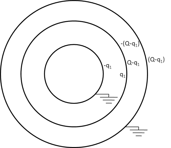

Please see the attachment if I have mentioned the induced charges properly (I think they are wrong).
If they are right, should I calculate the potential at the surface of innermost and outermost spheres and set them equal to zero?
I did these types of problems in the past but now I have completely forgotten how to do them. :(
  • Concentric circles diagram of three nested spherical shells in cross-section, labelled -q1 on the innermost shell, q1 and Q-q1 on the middle shell, -(Q-q1) and (Q-q1) on the outer shell; two ground symbols connect to the innermost and outermost shells.
Concentric circle diagram of three spherical shells with charge labels: inner sphere -q1, middle shell q1 on its inner surface and Q-q1 on its outer, outer shell -(Q-q1) on its inner surface and (Q-q1) on its outer surface; two ground symbols connect to the inner and outer shells.
That looks good to me, except for the charge on the outside of the outer sphere.
Yes, I too think that its wrong that's why I wrote in brackets that they look wrong to me. Any hint about what should be those charges?
that is zero outside.
ehild
The potential of the sphere is zero, so the electric field exterior to the sphere must be zero.
The charges mentioned on the inner surface of outermost sphere are right?
When I calculate the potential, do I need to add potential of both outer and inner surfaces of each sphere? :confused:
Yes. The charge on the inner surface are exactly opposite the charge on the outer surface of the middle shell.
No. (Assuming I understand your question correctly.)
The potential difference between the middle & outer shells should give you the charge, Q - q1 .
The potential difference between the inner & middle shells should give you the charge, q1 .
Apply Gauss's Law in the regions between the spheres. Integrate the electric field to get the potential difference between the middle sphere and the inner one, and also between the middle sphere and the outer one. They must be equal.
