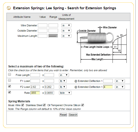

http://www.leespring.com/
As a retired american engineer who is required to use SI for many problems on this forum, SI is just as frustrating for me as US is for you.
ha, yeah - I understand. I think in my case it's a matter of wanting to solve, what seems to be, a reasonably simple problem. But being inundated with so much extra information that it makes me want to give up on the math, and just figure it out through experiment.
At any rate, the main reason I'm replying is to ask about that website you linked to. I go there, and I believe the type of spring I'll want is an Extension Spring. One end will be nailed/screwed/secured to the launch point, and the other will be secured to our chair. BTW, this video (below) showing what this guy built is what inspired our design. We are trying to build the same thing (more or less).
But getting back to leespring, do you happen to have a direct link to a spring meeting the general requirements? The site isn't terribly intuitive to someone with no prior experience in buying springs.

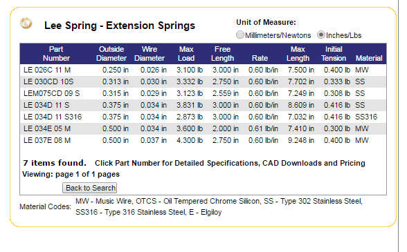

View attachment 114667 View attachment 114668
Ok, I'm able to repeat your values and get a list, but if I change just about anything, there are no results. After holding some springs in my hand at the store, and stretching them a bit, my feeling was that 4 inches isn't enough. So I plugged 6 inches into the spreadsheet to generate a new set of values, and am getting no results from the website. I tried 8 and 9 inches also, but no search results. Odd.
  • #48
When I run it I get a "no items found" result regardless of load or extension so that I suspect that the required wire size for that very low constant is too small. I did a quick catalog search on their smaller springs and the lowest rate is .16 on even very small springs with a .007 inch diameter wire size as you can see in the lower section of the below screen print of that section of their catalog.
