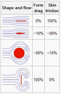

The drag coefficient CD has a pressure and a viscous component.
As seen if the diagram. most of the drag for a sphere is due to form or pressure and a smaller contribution due to the skin friction.
The explanation that I can think of is as follows.
For a half sphere facing upstream, there is less surface area and subsequntly the percentage of surface friction is less, and that could expalin the lower value. Hopefully a fluid expert will verify.
Note that the drag coefficient for a half sphere depends on its orientation - whether it is facing into or downstream of the fluid flow.
