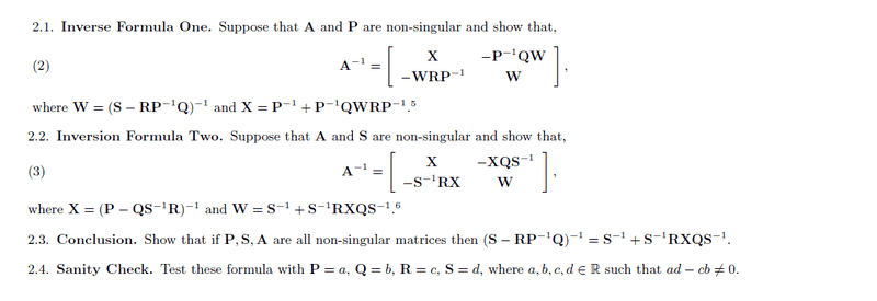

SpiffyEh
191
A=
[P Q
R S]
Suppose that A and P are non-singular and show that,
A^(-1) =
[x -P^(-1)*Q*W
-W*R*P^(-1) w ]
where W= (S-R*P^(-1)*Q)^(-1) and X= P^(-1)*Q*W*R*P^(-1)
Hint: First, remember that if you are given a candidate for an inverse then you need only check that the appropriate multiplication gives you the identity. Second, you must note that we are working with a matrix whose elements are matrices and when you perform a check you are checking blocks.Thus when you perform the check [A*A^(-1)]_11 you are finding the upper-left block of the product matrix and the result should be matrix and not a scalar. What matrix should you get for this block? What about the rest?
I'm completely lost about what to do with this problem. Can someone please show or explain to me what to do

I attached the problem. Between problem 2.1 and 2.2 there are some hints but I already posted the only one that's relevant to the problem earlier. It never really says which X to use or anything. Also, if you get a chance could you look at the link below please? I have all my work shown, I'm just unsure if I'm doing it correctly or not. Thank you
https://www.physicsforums.com/showthread.php?t=416582
Problem 2.2 looks to me to be similar to 2.1, the first one you posted. This time, show that
[tex]A^{-1} = \left[ \begin{array}{cc} X & -XQS^{-1}\\-S^{-1}RX & W \end{array}\right][/tex]
Use the values given for X and W that are below the problem. That's how I see it.
I got 2.2 to work out just like 2.1. I posted that so that you could see which X to use for 2.3 because it's a little confusing.
2.3 is actually pretty easy. In 2.1 and 2.1 you are finding A-1 using two different techniques. In 2.3 they are asking you to show that W in the matrix of problem 2.1 equals W in the matrix of problem 2.2. If a matrix (A) has an inverse, the inverse has to be unique, so W in the one representation must equal W in the other representation. I think that's all there is to it.
hmm.. that seems too simple but I can't see how they got from one to another by subsituting in so I guess that will have to do. I mean it makes sense but it just seems to easy.
In 2.4 I'm supposed to check it. Is this where I would plug in the values given and try to subsitute a formula in for X?
In 2.4, matrix A will be just a regular 2 x 2 matrix that is invertible. If you use the representation of A-1 that is shown in 2.1, use X that is defined for that problem. If you use the representation that is shown in 2.2, use the X that is defined for that problem.

In prob. 2.4, A is a matrix of constants, not blocks. P, Q, R, and S are just numbers in this problem. So S-1 would just be the reciprocal of what you have for S.
oh ok, thank you. I got it to work out and I understand it now.
