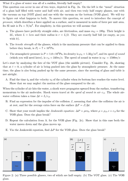

Some1WhoNeedsHelp
Poster us reminded to always show their work in schoolwork questions
Find the time and velocity of the cylinder
ρ=m/V
I am stuck at A, how do you calculate the motion of the air?
I know ρ=m/V but what is the mass of the air, or I got that question wrong?
Thanks

Doesn't it vaguely say the motion of the air can be neglected ?
The opposite… that the motion of the glass can be neglected in comparison to the motion of the air. Even then, we are told to show that, not assume it.
I think you are supposed to treat it as a body of air, at atmospheric pressure, of the same volume as the space to be filled. As such, it is just a mass to be propelled by a constant pressure difference.
What bothers me is the mix of basic and advanced concepts in the one question. Makes it hard to know what degree of sophistication is expected in the answer. Are we expected to treat it as Bernoulli for compressible fluid?
I guess we can rule out a molecular kinetics approach, in which there would be no specific time at which the air as a whole reaches the water. Rather, some molecules would arrive at up to 400m/s, others rather later as they bounce around along the way.
