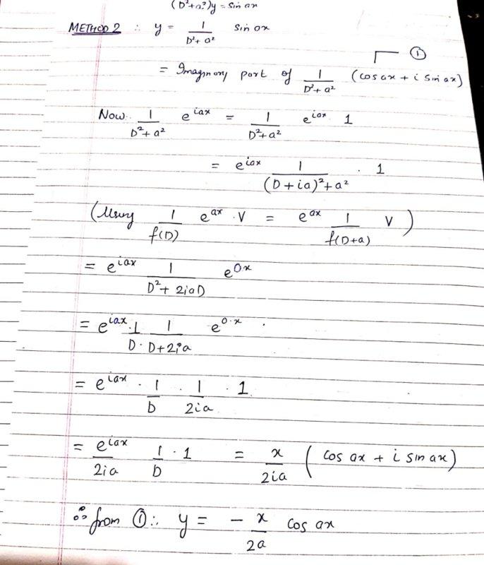

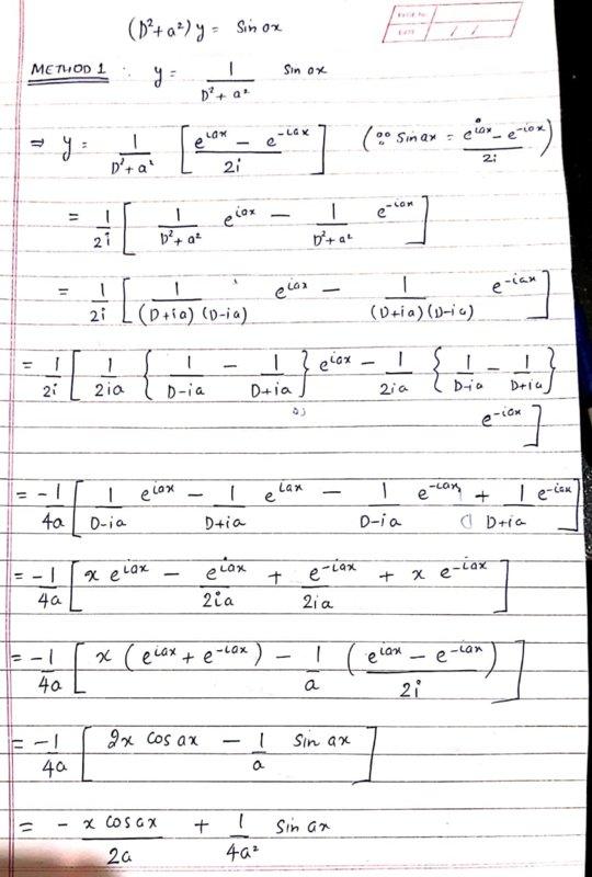

vish_maths
60
I have tried calculating using two different methods and both of them yield different results. Could someone please pinpoint any error in Method 1 which I might be making. **My textbook uses method 2.** Thanks a lot for your help
1/(D-b) e^(bx) = x e^(bx)

[tex](D^2+a^2)y=0[/tex] is a equation of harmnic oscillation so it has a general solution
[tex]y=A \sin ax + B \cos ax[/tex]
which can be added to the solution of your method II.
vish_maths said:
Homework Statement:: I have tried calculating using two different methods and both of them yield different results. Could someone please pinpoint any error in Method 1 which I might be making. **My textbook uses method 2.** Thanks a lot for your help
Relevant Equations:: 1/(D-b) e^(bx) = x e^(bx)
View attachment 256543View attachment 256544
Why do you think you've done anything wrong? Have you checked your answer?
I must admit I'm not familiar with this technique, but you have picked up an additional solution to the homogeneous equation.
Given this is a second-order DE, there ought to be two linearly independent solutions.
You have them both; the book method finds only one.
