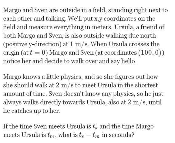

Typed physics word problem on a white background: Margo and Sven stand at (100, 0) while Ursula walks north at 1 m/s from the origin; Margo and Sven walk at 2 m/s, asking for t_s minus t_m in seconds.
Calculating ##t_m## is easy but I have no idea how would I calculate ##t_s##. I understand what kind of path would Sven take but I don't know how to form equations in her case. :confused:
  • Printed physics word problem on Margo, Sven and Ursula's positions and walking speeds in meters, asking for t_s minus t_m in seconds.
Hint: think of a circle centred at (100,0) with time-varying radius intersecting the y-axis at some point. The circle represents the locus of all the points that Margo might reach at time t. What conditions can you impose so that Margo reaches Ursula?

No, I'm talking about Margo (the one that knows physics). She's basically going to take a linear path that will directly intersect Ursula's. You know the speed this path will take (2m/s). Problem is - you don't know the direction (angle with x-axis). That's why you need to consider circles of time-varying radius to represent Margo's locus (think of a ripple in a pond traveling concentrically outward at fixed speed).
That equation looks good. At time t, what's r?
What's Ursula's position at time t?
Solve those simultaneously.
EDIT: I should maybe have said *set of circles* to avoid confusion.

Sorry, Pranav, maybe you should ignore what I said. I thought you had difficulty with Margo, not Sven. (I was confused because you used "her case", and Sven is a male name). Margo is definitely the easier case.
For Sven, I'll see if I can think of something (basically, the tangent to the curve always has to intersect Ursula's position).
If Ursula is at (X, Y) and Sven at (x, y), what is the direction from Sven to Ursula? And if Sven always walks in that direction with a constant speed, what is Sven's velocity at that instant?
Pranav-Arora said:
Printed text problem: Margo and Sven stand at (100, 0) while Ursula walks north at 1 m/s from the origin; Margo walks at 2 m/s to meet her in shortest time, Sven walks directly toward her at 2 m/s; find t_s - t_m in seconds.
OK, I worked out an outline of how to handle Sven.
Set up a pair of simultaneous differential equations using what's known about Sven's trajectory:
First equation is the velocity relationship. Sven has an x component and a y component to his velocity at any point (x,y). The magnitude of the resultant (vector sum) is a constant. Hint: Pythagoras.
Second equation relates the tangent of Sven's path at (x,y) to the gradient of the line joining that point to Ursula's position (0,t).
I can reduce these equations to a slightly ungodly looking second order non-linear d.e. in terms of only y and x. Surprisingly, Wolfram assures me of a simple solution, which you can then use to calculate the t at intersection.
I don't know if this is the simplest way to do it, but it'll work.

OK, had more time today. Solved the d.e. by hand, and it's actually very easy. Pranav - use Voko's hint to let ##z = \frac{dy}{dx}## and proceed from there.
I get a nice rational answer for Sven's time. I'm not sure why Wolfram was giving that solution, but the actual solution is much simpler by hand.
The difference in the times between Sven and Margo is about 9s (you should give the exact answer when you work it out).

I tried your suggestion, this time I get:
[tex]z=5\left(\frac{\sqrt{x}}{100}-\frac{1}{\sqrt{x}}\right)[/tex]
Substituting z=y' and integrating x from 100 to zero and y from 0 to t, I get ##t_s=200/3##. Is this what you get?
Also,do you get, ##t_m=100/\sqrt{3}##?
Thank you for your patience Curious! :smile:
Exactly right.
Also right!
The difference simplifies to ##\frac{100(2 - \sqrt{3})}{3}##, which is just under 9s, as I mentioned.

Can I use this to find the equation of path taken by Sven?
Pranav-Arora said:
Thanks, I too thought of the same trajectories. :)
Is it possible to find the equation of path taken by Sven? We had:
[tex]\frac{dy}{dx}=5\left(\frac{\sqrt{x}}{100}-\frac{1}{\sqrt{x}}\right)[/tex]
Of course! I thought you had. :)
Just solve that d.e., it's a very simple separable equation, and you only need to know how to integrate algebraic expressions. Remember that when x = 100, y = 0, that's your lower bound for the integration.
I'm curious (like my name suggests), but if you didn't solve that d.e., how exactly did you arrive at the time for Sven? I solved that d.e., and that's how I found that time. That curve I plotted is exact, and uses that equation.
