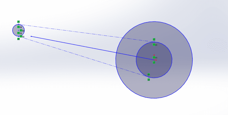

Hi there, I am an engineering student studying my masters, but have run into a roadblock in my calculations. I know I'm missing something obvious but i just can't see it. Too close to the woods and all that!
Anyway, i have the rear end of a motorcycle. to calculatew the overall moments, i have to find the three individual moments acting on it. the first two I'm fine with, but the third I'm struggling.
I have a rear end of a motorcycle. The wheel has a sprocket/ gear rigidly attached. A chain connects this gear to another at a distance Lc centre to centre and angle eta with a tension T. Lc is constructed of a triangle with sides a (horizontal) and b (vertical). The wheel is attached to a swingarm with length L, and angle to the horizontal of phi. The gears have radius Rc and Rs. The front sprocket rotates at V rad/s and transmits a power P.
I have attached a diagram to help.
Diagram of a rotating disc with concentric inner circle and a small circle at left, with dash-dot lines and a solid blue line from the small circle's centre to the disc centre, showing a force or tension line.
From research, the moment should be;
T*(Rc - L*sin(phi-eta))

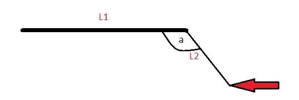

I can get the equation by working backwards, but i don't understand how it works. The basics physics question is this. If i have a system such as below, how do i calculate the torque?
Sketch of a horizontal bar L1 with a bent arm sloping down to the right, labelled L2 and angle a at the bend, ending in a red arrow pointing left at the lower end.
if the torque was applid to L1, i would just use T = F.r.sin(theta), but I'm unsure how to resolve the forces for this.

  • Diagram of a rotating disc with concentric inner circle and a small circle at left, with dash-dot lines and a solid blue line from the small circle's centre to the disc centre, showing a force or tension line.
  • Sketch of a horizontal bar L1 with a bent arm sloping down to the right, labelled L2 and angle a at the bend, ending in a red arrow pointing left at the lower end.
When you say you're trying to calculate "the overall moments" what are you referring to?
I'm kind of assuming the speed/acceleration of the driving wheel, in which case the suspension geometry doesn't play into the calculation at all. Just compare the ratio or radii between the two sprockets for the torque multiplication, and apply a reasonable efficiency factor for power loss through the chain drive.
Am I missing something that you're trying to calculate?
