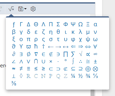

That's not upthrust but pressure. Using both Pand p is asking for trouble. There is a list of symbols under the ##\sqrt x## button:
But using ##\LaTeX## is infinitely better.
