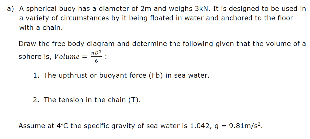

A Spherical buoy has a diameter of 2m and weighs 3kN. It is designed to be used in a variety or circumstances by it being floated in water and anchored to the floor with a chain. Draw the free body diagram and determine the following given that the volume of a sphere is,
Volume = πD3/6
  1. The upthrust or buoyant force (Fb) in sea water.
  2. The tension in the chain (T)
Assume at 4Degrees the specific gravity of sea water is 1.042, g = 9.81m/s^2

This is the question i am trying to complete:
Printed homework question about a spherical buoy with a 2 m diameter and 3 kN weight, asking for the free body diagram, upthrust in sea water, and chain tension, with sphere volume formula πD³/6 and sea water specific gravity 1.042.
Maybe they have sea water as just an example?
So with this question is it correct?
In order to calculate a tension on the chain, don't you have to know the depth that the chain pulls the buoy below its normal floating depth? If the chain allows the buoy to float at its normal depth, then I don't think there will be any tension on the chain. Maybe the question wants you to assume that the buoy is completely submerged.
I though Tension was. T = w - Fb
The amount the buoy floats which is Fb let's us calculate it?
I don't know if this is what the problem expects you to do, but here is my two cents:
As long as the maximum buoyant force is greater than the weight, then the buoy can float on the water while partially submerged and the actual buoyant force equals the weight. In that case, I don't think there is any tension on the chain.
I suspect that this answer is not what the problem wants because it may not be requiring you to use what you are learning in the class. Your calculation is for a completely submerged buoy, held underwater by the chain. That is probably what the problem wants.
[ATTACH type="full" alt="Part 2 Archimedes.png"]262088[/ATTACH]
1.042kg/m3 is certainly not the correct density.
Most likely 1042kg/m3 is the correct density.
@Ben_Walker1978 , What is the density of water (NOT sea water), and what is the definition of "specific gravity"? You need to get this right to calculate the density of sea water.
