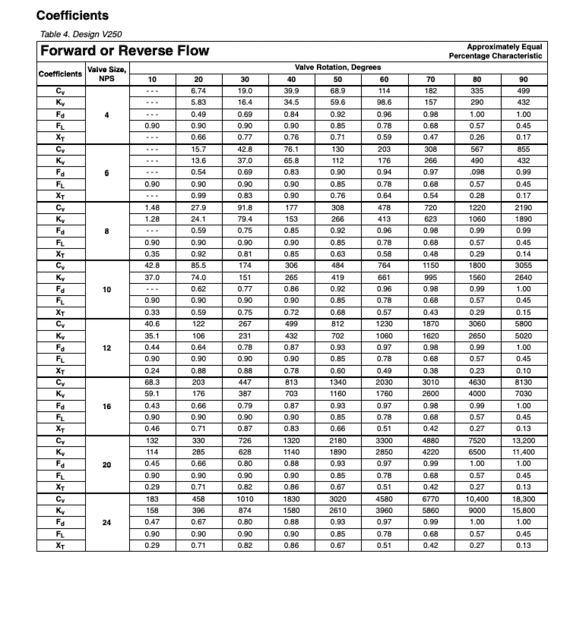

A valve is required to regulate the flow of natural gas. Details of the gas are given in table below. It can be assumed that the pipe size and the valve size are the same [i.e. piping geometry does not have to be allowed for]. The chosen valve type is the V250 rotary ball valve by Fisher
Controls International [the V250 data sheet is available on Blackboard].
- Determine the required valve size in inches from the range of sizes given in the data sheet [the data sheet gives a range of nominal pipe sizes (NPS) in inches].
- Estimate the percentage the chosen valve would have to be open to carry the required flow.
REquired volumetric flow rate [@STP] 2.6 X 10^6 litres per minute
Density [@ STP] 0.752kg per m^3
Specific Heat Ratio 1.31
Inlet pressure 20 bar gauge
Outlet pressure 6 bar gauge
Inlet temp 20ºC
Kv=qm/31.6YSQRT(xp1P1) .........for non choked flow
Kv=qm/21.1SQRT(F_yXtp1P1) ..... for choked flow
where kv is valve coefficient
qm is mass flow in kg/h
Y is expansion factor
Fy is the heat ratio factor
p1 density
P1 inlet pressure
Y=1-(x/(3FyXt)) ..........2
Fy = y/1.4
I have converted given pressures from bar gauge to bar abs
Inlet pressure = 20 - 1.013 = 21.013 bar abs
Outlet pressure = 6 + 1.013 = 7.013 bar abs
therefore pressure drop (x)
x = {p_1 -p_2 \over p_1 } = {21.013 - 7.013 \over 21.013} = 0.6662542236 bar abs
Comparing to the chart values for X_T I have determined flow is likely choked.
However, in the information given I don't have the mass flow rate (qm) so I am unsure how to progress to select a vale size.
Any help would be appreciated

Did you notice the given vol flow rate and the density ? The product would at least have the right dimension :wink: !

Whilst working on it over the weekend I have used the product of volumetric flow rate and density for now (thank you!)
In the textbooks, it says that the relationship between mass and volumetric flow rates for a compressible fluid is more complex than that for a liquid and quote the combined gas law and ideal gas law.
As these values have been given at STP has the "hard work" already been done for these calculations?
I am sorry I don't know what you mean by the two Fv are different?:smile:
Correct !
