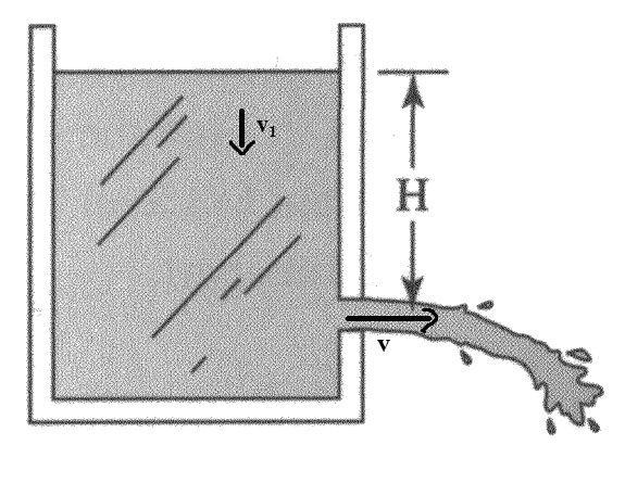

A tank of cross-sectional area ##A## contains a liquid having density ##\rho##. The liquid squirts freely from a small hole of area ##a## at a distance ##H## below the free surface of the liquid.
If the liquid has no internal friction(viscosity), with what speed does it emerge?
##p = H\rho g ##
##F = \frac{\Delta (mv)}{\Delta t}##
##F = pa = aH\rho g ##
Again, ## F = \frac{\Delta (mv)}{\Delta t} = v \cdot \frac{\Delta m}{\Delta t}## ; because, ##v## is constant;
Now, ## \frac{\Delta m}{\Delta t} = \frac{a (\Delta x) \rho }{\Delta t} = a \rho v ## ; because, ##\frac{\Delta x}{\Delta t} = v ##
So, ## aH\rho g = v \cdot a \rho v = a \rho v^2 ##
Finally, ## v = \sqrt{Hg}##
But, it doesn't match the answer.

OK. I calculated in this way:
##\frac {dP.E}{dt} = - \frac {d K.E}{dt} ## ; because, P.E. + K.E. = constant
##\frac {d}{dt} (mg \frac{h}{2}) = - \frac{d}{dt} (\frac{1}{2} mv^2)##; average height is ##\frac{h}{2}##
##\frac {d}{dt} (Ah\rho g \frac{h}{2}) = - \frac{1}{2} \frac{dm}{dt} v^2##; as, ##v## is constant;
##\frac {1}{2} A \rho g \frac {d}{dt} (h^2) = - \frac{1}{2} \frac{d}{dt}(- Ah \rho) v^2##
## g \cdot 2h \frac {dh}{dt} = \frac{dh}{dt} v^2##
## v = \sqrt{2gh}## ; which is the expected answer.
But still couldn't understand what's wrong in my previous approach?

The problem is that you are taking it as though the water accelerates instantaneously from 0 to v. That makes it like an inelastic collision, with about half the energy being lost. In practice, a much smaller portion of the energy is lost. The water accelerates more gradually from the area surrounding the hole from inside the tank. So assume conservation of energy instead (Bernoulli's principle).
Of course, some energy is lost to turbulence, so that doesn't give exactly the right answer either. Turbulence can be reduced by fitting a Borda mouthpiece inside the tank around the hole.

There are a couple of things wrong with your approach, and yet you still get the correct answer to within a factor of 2.
First of all, you are assuming that all the "action" is taking place right at the exit cross section, where the pressure suddenly drops from P to atmospheric and the velocity suddenly increases from zero to the exit velocity. This would be equivalent to an impulsive force at the exit cross section (like in a collision), which is not the case. In the real physical situation, the pressure in the tank is decreasing gradually as the fluid approaches the exit cross section, and its velocity is increasing gradually. So assuming that the pressure P (far from the exit) times the cross sectional area at the exit A is the force that accelerates the fluid is incorrect.
Secondly, in the real physical situation, the fluid is not traveling in a horizontal line toward the exit. On the contrary. It is essentially converging radially toward the exit cross section, as if the exit cross section were a spherical point sink, with the surfaces of constant pressure being nearly hemispherical. Only within a distance on the order of about 1 exit cross section diameter from the exit do the streamlines straighten out and become horizontal. I hope you can see how this is very different from what you assumed.

Let the velocity in the tank be ##v_1## and the velocity at the hole be ##v## ;
So, change of mass in the tank per second ##= \rho Av_1## ; where, ##A## is the cross-sectional area of the tank.
And, the amount of water flow per second at the hole is ## = \rho av## ; where, ##a## is the cross-sectional area of the hole.
So, it becomes,##\rho Av_1 = \rho av##
Hence, ## v_1 = \frac{a}{A} v ##
So, I thought , the speed of the water in the tank would be constant (which is equal to ##v_1##) and the speed of water at the hole would also be constant (## = v##). And I thought, as soon as the water reaches at the height of the hole, it suddenly changes its velocity (which is in the horizontal direction).
Would you please clarify this point ?

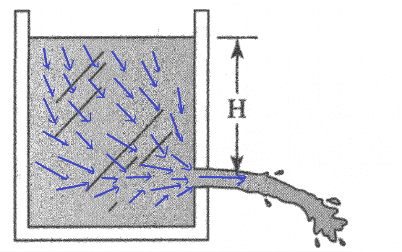

This is not what happens. To get an idea of how the parcels of fluid in the tank move, imagine a very long room full of people (from wall to wall) with an exit door on the long wall not very far from the corner. The short wall far from the exit door begins to move toward the people, and the people realizing that they might get squished begin to file toward the door. The wall moves in such a way that the number of people per unit area in the room remains constant. In the region close to the door, all the people will be converging radially toward the door. Even beyond the door, in the part of the room toward the non-moving short wall, people will be moving toward the door (with a velocity component opposite to that of the moving wall). So, aside from the people right next to the moving wall and rigid walls, all the people in the room will have velocity components both parallel and perpendicular to that of the moving wall, and some of their parallel components will even be opposite to that of the moving wall.

This was helpful to understand the matter. So, I think the velocity will be (roughly) something like the picture below:
And I conclude, there is no easy way to calculate the exit velocity using the formula : force = rate of change of momentum with time.
It's better to use the energy conservation law for this problem.
Thanks for your explanation.

Yes. Yes. Yes.
Chet
arpon said:
All I would add is that you have arrows rising from the lowest layer towards the exit, so there should be arrows down into that layer on the left hand side.

I agree with you.
