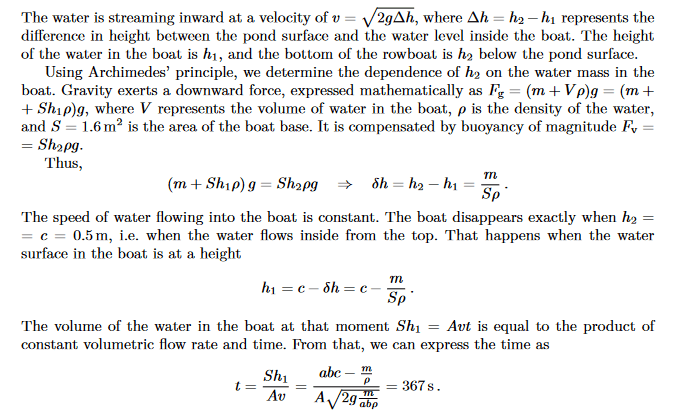

I have a problem with understanding the solution of the problem below. At the beginning, there is a formula for the speed of water streaming inside the boat. But I don't know how to calculate it.
##v=\sqrt{2g(h_2-h_1)}##

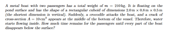

The problem:
Its solution:

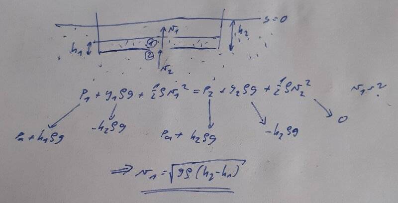

I am sure that the velocity ##v## can be calculated by using Bernoulli's equation, but I fail to calculate it.
I don't know what pressure is at the hole - is it ##h_2 \rho g## or ##(h_2 - h_1) \rho g##? The pressure of the water "under" the hole is ##h_2 \rho g## and the pressure just "above" the hole is ##h_1 \rho g##. So what is the pressure at the hole? Is it its difference?
And I am also a little bit surprised that I can calculate the buoyancy when there is a hole in the boat. I thought it could be calculated only when the submerged body is without holes - when a liquid is only around the body, not inside of it. Why can I ignore the holes and calculate the buoyancy as if there were none?
There is a pressure a little way outside the hole and a lower one a little way inside. That pressure difference accelerates the water through the hole, according to the Bernoulli equation.

Ok so how to calculate the velocity from Bernoulli's equation?
The pressure above the water surface is ##p_a## and pressure at the hole is, I would say, ##(h_2-h_1)\rho g +p_a##. Let's suppose that velocity of the water surface is zero and that the "potential energy" is measured from the water surface of the pond. So then I would write the equation like this:
##p_a - (h_2-h_1)\rho g = p_a + (h_2-h_1) \rho g -h_2 \rho g +\frac 12 \rho v^2##.
Apparently, this isn't correct. So where is the mistake?

Yes, but only until the water has entered the boat. Bernoulli is basically a conservation of work equation. The water is accelerated through the hole, but then what?
Initially , in principle, it has the right KE to reach the surface level of the surrounding water. But even if so, it would just fall back in the boat. As the water builds up in the boat, the new water entering just swashes around with that, so mechanical energy is lost.
Hence you can only apply Bernoulli for the transition through the hole.

So if I understand it well, I can't apply Bernoulli's equation on the whole water in the boat - so I can't work with the water surface for example.
So I tried to calculate the velocity from the equation on the photo:
Is it correct?
haruspex said:
The first equation looks right, but you then dropped a factor of 2.
Yes, sorry, my fault.
But I am still a little bit confused that the pressure under the hole is ##p_a+h_2\rho g##. Because what about the Pascal's law? Why don't we add ##h_1\rho g## to it, the pressure generated above the hole?
For the same reason we do not add ##h_1## to ##h_2## to find the depth just below the hole.

But what I still don't understand is the magnitude of the buoyancy force. Why is it ##Sh_2\rho g##? Because the buoyancy force is the net hydrostatic force acting on the body, and the net hydroststic force should be ##(S-A)h_2\rho g##, because the surface the force is acting on is ##S-A##. Or not? Why?
When the hole first appears, yes it is reduced to S-A. As a result, the boat accelerates downwards. But as the water level rises in the boat, the water accelerated through the hole exerts pressure on the boat+water system. As this restores the buoyancy to somewhere close to its original value, the acceleration downwards of the boat declines.

##(h_2-h_1)\rho g## is an upper bound for the pressure difference through the hole. That puts an upper limit on the velocity of water through the hole, and hence an upper limit on the rate of sinking. Hence the net force must tend to zero.
