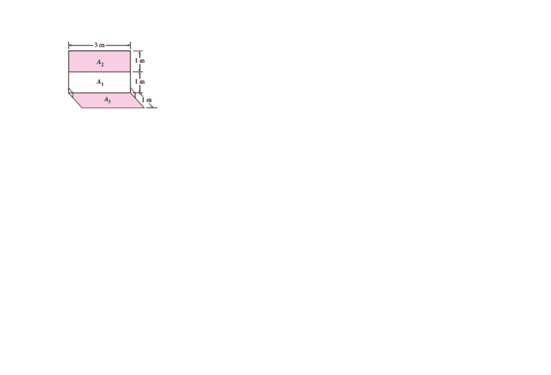

I found the values ##F_{3\rightarrow(1+2)}=0.32## and ##F_{1\rightarrow3}=0.25##
I now want to find ##F_{2\rightarrow3}##
Reciprocity relation
##A_iF_{i\rightarrow j}=A_jF_{j\rightarrow i}##
Using the reciprocity relation to find ##F_{(1+2)\rightarrow3}##
##A_3F_{3\rightarrow(1+2)}=A_{(1+2)}F_{(1+2)\rightarrow3}##
##3(0.32)=6F_{(1+2)\rightarrow3}##
##F_{(1+2)\rightarrow3}=0.16##
Using that to find ##F_{2->3}##:
##F_{1\rightarrow3}+F_{2\rightarrow3}=0.16##
##0.25+F_{2\rightarrow3}=0.16##
##F_{2\rightarrow3}=-0.09##
But I get a negative value
I don't think ##F_{(1+2)\rightarrow3}=F_{1\rightarrow3}+F_{2\rightarrow3}##
