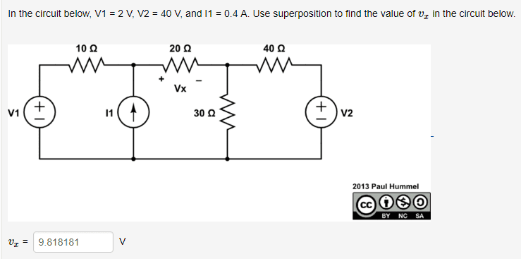

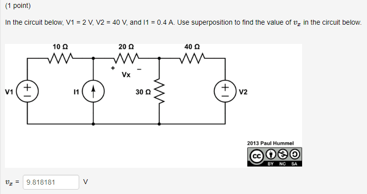

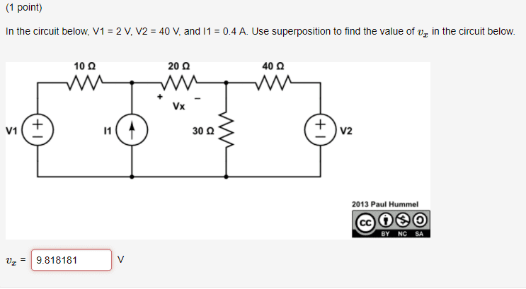

Calculating Vx in a Circuit with Superposition and Kirchoff's Laws
  • Topic: Engineering
  • Thread starter Thread starter Mark Nussbaum
    Circuits Superposition
2 replies · 2K views
Mark Nussbaum
current/voltage division
V=IR
Kirchoffs Laws
NjqKa5v
and adding all Vx I get 9.818181V.[/B]
V=IR
Kirchoffs Laws
NjqKa5v
You've got a sign error. The component of Vx produced by the 40 volt source is -80/11, not +80/11.
