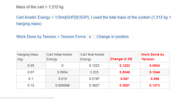

See the attached picture for the lab setup. It is all about releasing a cart of 1.212 kg attached with a string and hanging masses.

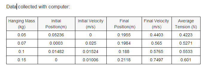

I recorded the Initial and final velocity, initial and finial position, and the tension force .
Ps. I follow the instructions on the lab manual to do calculations. It did not say I have to consider potential energy.
The work done by tension is supposed to equal to the change in kinetic energy of the cart, but I don't know why I can't get that result.
So I wonder which mass should I use to calculate the Change in Kinetic Energy of the Cart? The mass of the hanging mass only? The mass of the cart only? Or the total mass of the system?
Work done by tension = Tension force x (final position - initial position)
Change in Kinetic Energy of the Cart = 1/2 MVfinal2 - 1/2 MVinitial2I appreciate your help!
Data collected with computer:
Calculations
The problem is that Change in KE and the Work Done by Tension have huge difference!

How did you calculate the tension in the string?
Where does the KE of the cart come from? Where is that energy initially?
I use computer to collect data for tension. I guess the energy of the dart comes from the hanging mass.

The work done by tension is supposed to equal to the change in kinetic energy of the cart, but I don't know why I can't get that result. There is a huge difference between the work and change in kinetic energy.
How can anyone help if you don't say what results you've got? Your computer could be giving you the wrong answer.
I've merged sallychan's latest post with the original in order to add the results. Please see the original post once more.
The numbers clearly don't add up in a number of ways. How does a computer measure tension in a string? If the tension is measured incorrectly, then that would explain some of your problems.
Part of the problem might be that you are adding the mass of the hanging weight in yout KE calculation.

I'd say the most likely explanations are:
a) The cart is only about 0.6 Kg.
b) The computer measures the tension at about half what it really is.
c) The computer measures the final velocity greater than it really is.
d) The cart is on a slight downslope.
Note that if you do consider PE of the hanging mass you have the added problem that the KE of the cart is greater than the PE lost by the hanging mass.
In other words, you've found significant experimental errors in the set-up.

Yea I guess the data I got is probably not accurate.
By the way,I am just asking, when I calculate the KE of the cart, should I use the mass of the cart only or the total mass of the system?
And should I consider PE of the hanging mass?
You don't need the PE of the hanging mass, although it was a useful check that your data made sense, or not.
If you are using the tension in the string, then the work done is accelerating the cart, so you should only use the mass of the cart.
