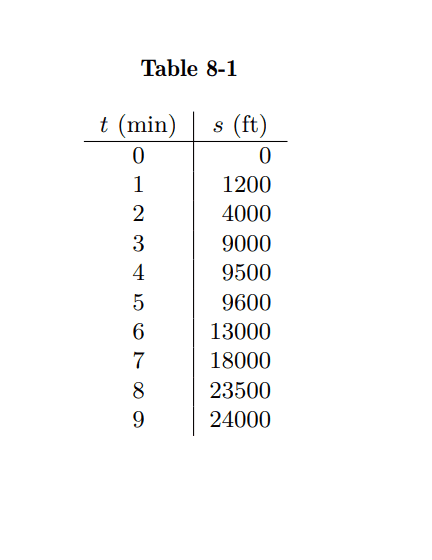

"We know only where she was at intervals of one minute from the table; we can get a rough idea that she was going 5000 ft/min during the 7th minute, but we do not know, at exactly the moment 7 minutes, whether she had been speeding up and the speed was 4900 ft/min at the beginning of the 6th minute, and is now 5100 ft/min, or something else, because we do not have the exact details in between. So only if the table were completed with an infinite number of entries could we really calculate the velocity from such a table."
From feynmans lectures on physics. Vol 1.
Isnt it should be during the 6th minute?
And in the bold , does it talk about the average speed which is firstly 4900 during 6th minute and then 5100 at the end of 6th minute.
The 1st minute is the time-interval from t=0 to t=1min.
The 7th minute is the time-interval from t=6min to t=7min.
From the table, the average speed durig the 7th minutes is 5000ft/s. So the reference to the “7th minute” is correct.

I also find that a little confusing. Maybe “at the beginning of the 6th minute” should actually say “at the beginning of the 7th minute”. That would make more sense.

Confusing how? We are at t=7 minutes. This is at the end of the 7th minute, not the beginning. The average speed during the preceding minute (the seventh minute) was 5000 feet per minute.
This could have been achieved with uniform acceleration from v=4900 at t=6 to v=5100 with t=7.
If we were to assume that position is continuously differentiable (i.e. that position is continuous, that it has a first derivative that is defined everywhere and called "velocity" then we can apply the mean value theorem:
https://en.wikipedia.org/wiki/Mean_value_theorem said:
Let ##\displaystyle f:[a,b]\to \mathbb {R}## be a continuous function on the closed interval ##\displaystyle [a,b]##, and differentiable on the open interval ##\displaystyle (a,b)##, where ##\displaystyle a<b##. Then there exists some ##\displaystyle c## in ##\displaystyle (a,b)## such that
$$\displaystyle f'(c)={\frac {f(b)-f(a)}{b-a}}$$
Correlary: If the average velocity is 5000 feet per minute for the 7th minute then the instantaneous velocity must be exactly 5000 feet per minute at some time during the 7th minute (i.e. between t=6 minutes and t=7 minutes).

The original passage (Post #1) specifically refers to “the beginning of the 6th minute”, i.e. t=5min:
"the speed was 4900 ft/min at the beginning of the 6th minute"
A clearer explanation (in my opinion) would have been to use only:
- the instantaneous speed at t=6min;
- the instantaneous speed at t=7min;
- the average speed during this interval (i.e. the7th minute).
The speed could have been 4900 ft/min at t=6min and 5100 ft/min at t=7min.
The confusion (maybe 'lack of clarity' is better) is the use of the instantaneous speed at t=5min - which is outside the period of interest (the 7th minute). For a clear explanation, we do not want to have to consider what happens in the 6th and 7th minutes when we only need to consider what happens in the 7th minute.
Just my opinion though!

Ahh, gotcha. I read right past "beginning of 6th minute", interpreting it as t=6. As the writer likely intended but did not correctly convey.

The units were feet and minutes. How did we get to kilometers and seconds? And how did we get to 160 distance units traversed during the one minute between t=5 to t=6? The chart says 340 feet.
As I understand it, you want to know from the stated position measurements at t=0, t=1, t=2, etc the instantaneous speed at t=5 or at t=6. You cannot determine either answer from the given information.

No. Also, you are mixing minutes and seconds which adds to the confusion.
You can't determine an exact instantaneous speed from a table of times and distances. If you think you can, give a worked example to illustrate your method.

If there are an infinite number of entries and if they are dense in the domain of the function and if the function is continuous then those entries completely determine the function. The instantaneous velocity is defined as the derivative of the function.
So those infinitely many table entries would determine the instantaneous velocity at 5 minutes exactly.
However, if you want a finite procedure to take those entries and calculate the derivative then you are out of luck. There is no finite procedure to calculate a derivative from a table of function values.

Yes. We cannot calculate derivatives from tables. What we can calculate are average velocities. In principle, if you were to calculate average velocities over times like 0.001, 0.0000001, 0.000000000000000001 and so on, the averages you compute would get as close to the derivative as you please.
Indeed, this is how the derivative is defined. It is the limit that is approached (if one is approached) by the average rate as the time interval is reduced toward zero.
Note that experimental error becomes a bigger and bigger problem as one tries to focus in on smaller and smaller time intervals. In principle we can calculate better and better approximations to the derivative. In practice, we cannot.
