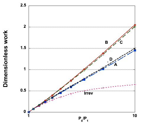

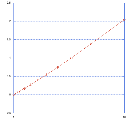

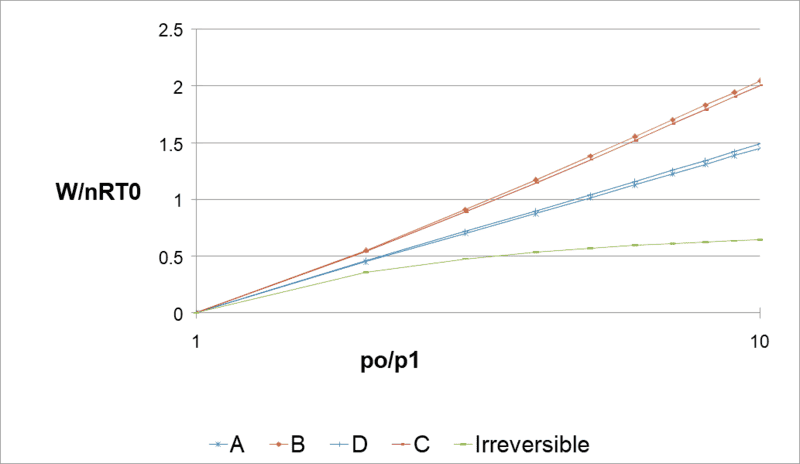

Please make a graph of the overall process work W as a function of Po/P1 (1.0 to 10.0) at constant ##\gamma = 1.4## for the 4 reversible paths and the irreversible path. Instead of W, please plot the dimensionless work ##\frac{W}{nRT_0}##. We want to see how the 4 amounts of reversible work compare with the irreversible work and show that the work is different between the reversible paths
I switched between using 1 mole for some and n moles for others ! Actually, I haven't calculated delta H, but will do so. and correct the errors related to #moles of the gas. I'll plot these graphs and upload tonight.

Please plot all the curves on the same graph.

Please select logarithmic for the Po/P1 axis scale.

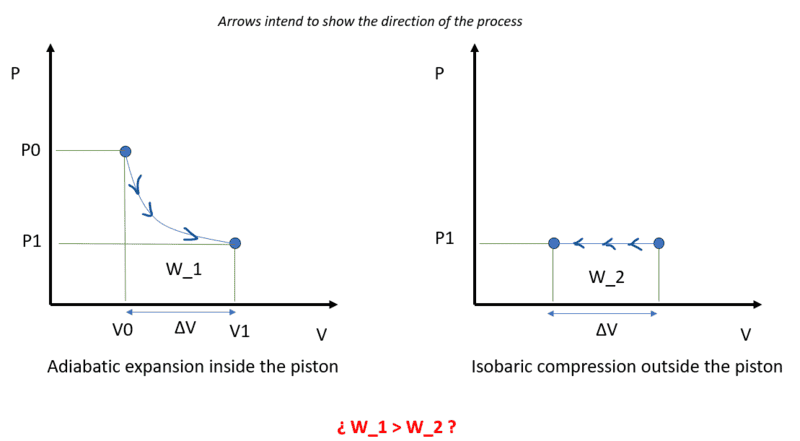

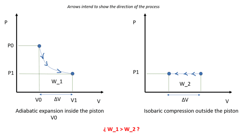

I'm pretty late to the party but I'd like to understand the problem posted because I'm having quite some trouble to understand it. In this case, I don't think it is I don't understand the math or know the formulas, I think I am missing some key fundamentals but I don't know which.
The way I see it, the work done by the adiabatic expansion of the gas inside the piston must be equal to the work done in the isobaric compression of the gas outside the piston. Is that right? Energy has no other place to go since heat transfer is not allowed (adiabatic system) and any other path for energy has been restricted (frictionless, massless, etc.).
The gas inside the piston will expand until its pressure levels with the outside pressure (P0→P1).
The energy required for such expansion would come from the internal energy of the gas inside the piston which can be expressed as a function of temperature (ideal gas).
However, I don't see how those two Works (adiabatic expansion in the piston and isobaric expansion outside) can be the same.
Two P-V diagrams: left shows adiabatic expansion from P0 to P1 with arrows on the curve, area W_1 and interval ΔV; right shows isobaric compression at P1 with arrows pointing left, area W_2 and interval ΔV; red question asks whether W_1 > W_2.
I'd need to include something else. For example, if the piston had mass, its kinetic energy would be ##K_p = W_1-W_2##.
I feel like that's a realistic scenario. @Chestermiller you mention how you drop the external pressure to P1. I'll try to propose an equivalent description for the problem. Let's say the piston is locked. Outside the piston, there is the usual ##P_{atm}##. If the piston's pressure is increased and then the locking mechanism is released, then the difference between inner and outer pressure would result in the expansion of the chamber. The kinetic energy from the piston would come from the difference in the works I wrote.
What am I misinterpreting to get such a different answer when compared with the rest of the thread? I feel it's related to the assumption "the work done by the adiabatic expansion of the gas inside the piston will be equal to the work done in the isobaric compression of the gas outside the piston" but I don't see how that could be wrong.

Is the piston still moving when the system equilibrates? If the piston has very little mass, does the gas still execute an adiabatic reversible expansion as suggested by your equation?
This post is a distraction from the issues and direction I wanted this thread to follow. Please resubmit these questions in a separate thread, and I'll be glad to answer. Thanks.

Please find attached the graphs for reversible processes A through D alongwith the irreversible one. Apologies for the delay, Chet. Thanks so much for your time and help.
I haven't checked the results for case A yet, but B looks correct. But cases C and D are not. Dimensionless work for C should be ln(V1/V0). The work for the irreversible case is definitely wrong; at Po/P1 =1, dimensionless work should be zero.
When I asked for a log scale on the abscissa, I didn't mean to show equal increments along the horizontal axis; I meant for you to select logarithmic scale on your graphics software. For case B, doing this I got
Plot of a red curve with circular markers on linear axes, x from 1 to 10 and y from -0.5 to 2.5, rising from about 0 at x = 1 to about 2 at x = 10.
I didn't follow your remark on the logarithms. I used log(po/p1) for the X-coordinate.
See my graph for B in the previous post. Your points should not be evenly spaced horizontally. I didn't ask you to change the numbers on the scale. I asked you to change the scale itself. Double click on the x axis. you should get a dialog box with a selection called scale, and showing linear. Just change the selection to Log.
I don't see how the system equilibrates. I see it would keep bouncing like a spring system. I guess that's where the irreversibility comes into place since it'd be the gas consuming the energy. But I don't see how the gas consumes that energy. Probably it's eventually transformed into heat but that heat cannot go anywhere (adiabatic) so then it'll be thermal energy in the gas.
Sorry about that. It was not my intention. I'll leave it here and just read the comments in the thread. Maybe I'll find the issue later. If not, I'll try to open that separate thread as you suggested.
Juanda said:
This post deviates from the original intention of the thread. Disregard it.I don't see how the system equilibrates. I see it would keep bouncing like a spring system. I guess that's where the irreversibility comes into place since it'd be the gas consuming the energy. But I don't see how the gas consumes that energy. Probably it's eventually transformed into heat but that heat cannot go anywhere (adiabatic) so then it'll be thermal energy in the gas.Sorry about that. It was not my intention. I'll leave it here and just read the comments in the thread. Maybe I'll find the issue later. If not, I'll try to open that separate thread as you suggested.
Like I said, I can answer all your questions about this, but not in the present thread. Is it that hard for you to start a new thread?
