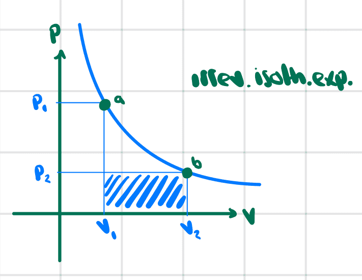

First let's consider an irreversible isothermal expansion from state a to state b as depicted below
We are given ##P_1, V_1, T_a##, and ##P_2##.
We can easily compute ##V_2## from the ideal gas law
$$V_2=\frac{nRT_a}{P_2}\tag{1}$$
Then
$$w_{ab,isoth}=-P_2(V_2-V_1)<0\tag{2}$$
$$q_{ab,isoth}=-w_{ab,isoth}>0\tag{3}$$
The area of the shaded region in the picture above is the work and the negative of the heat exchanged with an external reservoir.
$$\Delta U_{ab,isoth}=0\tag{4}$$
For the surroundings, we have similar expressions but with opposite signs.

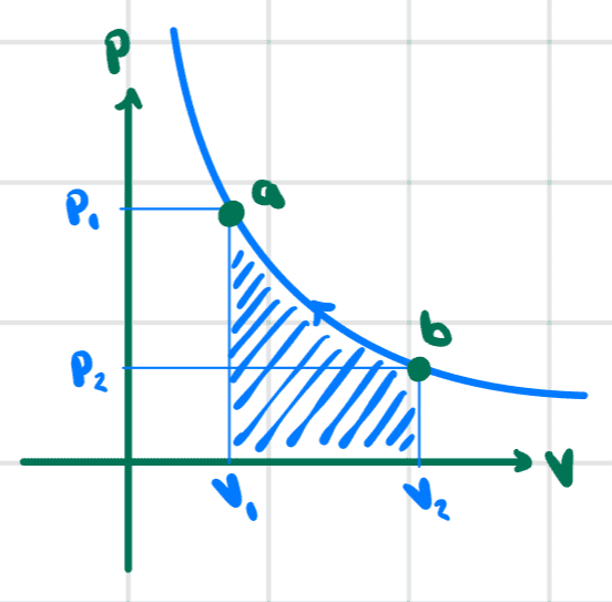

Now, consider the task of recompressing the gas to state a.
If we compress reversibly, then we have
$$w_{ba, rev}=-nRT\int_{V_2}^{V_1}\frac{dV}{V}=nRT\ln{\frac{V_2}{V_1}}>|w_{ab,isoth}|>0\tag{5}$$
$$q_{ba,rev}=-w_{ba,rev}\tag{6}$$

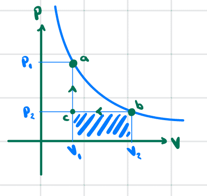

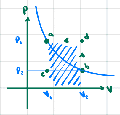

Consider the following two alternative ways of recompressing
I won't do the precise calculations here, but in the both cases above the shaded area represents both total heat outflow from the system and work done on the system. That is, in both cases, qualitatively we have ##w_{ext}>0## and ##q<0## and the sum is zero (no change in internal energy).
My question is: what is a didactical way to explain what it means that we cannot reverse the initial irreversible expansion?
The question above is posed naively on purpose. Of course we can return to the initial state (I just did it in three different ways above). I am not using the word "reverse" correctly I think.
If I knew how to pose the question conceptually correctly, I would probably not need to ask it in the first place. Not being cheeky here, I legitimately don't know how to pose the question.
Here is another attempt: in terms of the ability to go back to the initial state, what makes the reversible compression different from the irreversible processes shown above?
In all three recompressions, the surroundings must do work on the system and the surroundings receive heat from the system.
In the initial expansion (whether reversible or not), the system does work on the surroundings and the system receives heat from the surroundings.
In all the processes considered (expansions or recompressions) work and heat sum to zero.
The magnitudes of the work and heat in each case differ, however.
