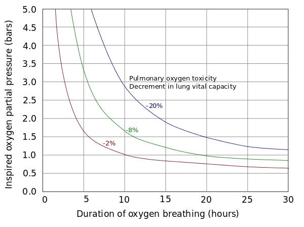

If I did the math correctly, the partial pressure of oxygen there would be around six times of on Earth. And yes, Oxygen is toxic.
I would say it would be quite bad within hours. (Six bar partial pressure is not even on this graph below.)
(Graph is from the linked Wiki page)

No. As other posters explained. 1,2 bar partial pressure of oxygen is fatal in a few days.
