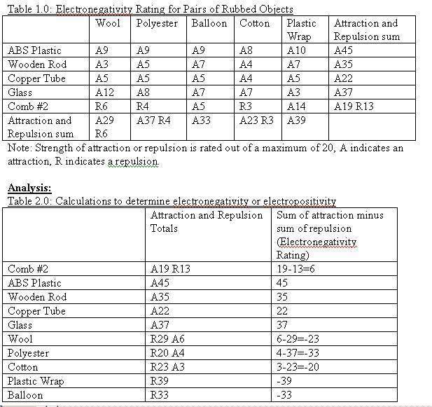

Lab: rub each of a set of hard materials against a set of soft materials. Hold the hard materials near a suspended, negatively charged comb (wool rubbed) to determine the charge polarity and strength on the hard item. Create a list of the hard and soft items used in order of electronegativity.
I qualitatively measured the attraction or repulsion between the charged items and the negatively charged comb with a rating from 0-20 in strength, this is recorded in a table.
Note that only the hard objects were held near the suspended comb and tested, in the Table 2.0 the soft objects have the attraction and repulsion amounts found in their sums from Table 1.0 switched because this is what they would have shown if held to the comb, since they gave or took the charge from the hard items.
The problem: One hard object, a second comb, used as one of the hard objects, attracts the comb when rubbed by some soft items and repels the comb when rubbed by other soft items. I reconciled this by taking the difference between the amount of attraction and repulsion between the comb and that object. Is there a better way I can do this calculation to determine the electronegativity?
