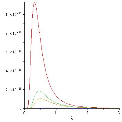

This is the third problem of a project for a Calculus II course. My issue is with graphing. Below is the problem, and below that my tutors explanation via e-mail to try and help me. I understand everything thus far, except for how I go about graphing. I am not strong in Excel. Problems four and five, as found in the pdf attachment or linked http://www.stewartcalculus.com/data/ESSENTIAL%20CALCULUS%20Early%20Transcendentals/upfiles/projects/ess_wp_0808_stu.pdf" , use the graph as well, so its important I do graph it.
Why on Earth would you try to use Excel for that? Use something like Maple.
I have never used Maple, sadface. Is it easier to input larger equations in Maple than Excel? The Excel operators seem alright for my physics labs, but I am dumbfounded here.

I have been able to get my charts going decently, my only issue is a "DIVIDE BY ZERO" when I have the -1 in there. seen here:
My initial value of A4 is 1nm. Not sure what the issue is.
=(((8*3.1415926535*(6.6262*10^-34)*(2.997925*10^8)))*(A4^-5))/(EXP(((6.6262*10^-34)*(2.999*10^8))/(A4)*(1.3807*10^-23)*5700))
Sorry I didn't get back to you sooner, I was workin on my own problems lol I just assumed this worked. Know what they say about that...
I think I have a solution. I definitely know what's wrong. It's because Excel has a data type limit that is smaller than I thought, apparently. So long story short the calculation of the power of e is closer to 0 than excel has digits to store, so it thinks it really IS 0, and evaluates exp(...) as 1. This is why you should use MATLAB :) Although I'm sure you can run into this sort of error there, too, I haven't yet, and this is the first time I've tried it w/ excel and look what happens lol.
So we just need to optimize the code to work around that. Should be able to get it to work, though. Give me some time I'll get back to you. This isn't due tomorrow I hope? :(
I sent you a PM, btw.
Alright, so I figured something out that works. I graphed my results from 1nm to 2000nm (which is a good range to get a good picture of the graph - except there's still some sort of error due to lack of precision for 1nm, 2nm, and 3nm, but it doesn't really matter) and compared it to ones I found online and it looks to be very accurate. Here is what I did:
I multiplied out 8*pi*h*c. I don't believe this part had anything to do with the problem, but it is always a good programming practice to do this sort of calculation beforehand and hard code it in. The reason is because I only had to do it once. However, the machine has to do it 2000 times. That's 8000 calculations. If this were a less nicely behaved function (you'll see what I mean when you graph it), and you wanted to see it's behavior over a large distance, you might need more than 2000 points. You might also want to see it's behavior over all temperatures from 300 K to 5700K, and use the 2000 points described above. Then its 10800000 calculations. Also, it will take less memory.
The problem was with the exp function. I really couldn't figure out why it was doing what it was doing, I was playing with it for a while. But if you do the same thing as above, it should work, because that's all I did and it came out good. I swear I had the same thing half an hour ago and it wasn't working, though... If I had to venture a guess, I would say the problem was with all the unsimplified exponents. At any rate, now you know why you should use MATLAB or maple or something lol. Another lesson on the limitations of computers.
Also make sure your units are right when you enter the wavelengths (should be entering 1x10^-9 for 1nm). If you start at 1 nm and go in increments of 1 nm, you don't need to worry about changing the x axis. Just highlight column B, and tell it to make a graph. It will automatically use the row numbers (which will be the correct number of nanometers) for x-axis markers.
Your graph should look like attached. Sorry, not allowed to post answers so I can't give you the exact formula and had to take numbers off graph.
Basically, multiply everything out and simplify exponents and hope for the best! :)
PS - When I multipled out everything I went online and found numbers with more significant figures to start with for the constants. I doubt it matters but if there's a slight difference between our graphs that's probably why.

Just to reiterate why it is a good idea to use appropriate software, here's how easy it is to implement in Maple code:
restart;
h := 6.6262*10^(-34);
c := 2.997925*10^8*10^6; #units of micro-meters
k := 1.3807*10^(-23);
f := proc (T) options operator, arrow; 8*Pi*h*c/(lambda^5*(exp(h*c/(lambda*k*T))-1)) end proc;
#Comment, the above proc is actually entered by just typing the formula
> plot({f(3400), f(5700), f(6400), f(9200)}, lambda = 0 .. 3);
5 simple lines of code.
Thank you both so much! So the project was due today, in a way. We had to present. This morning I went to school early and played around with Maple, within a half hour or so I was able to make a graph, totally incorrect, but a graph nonetheless to show during my presentation. Excel I gave up on after asking another classmate if they knew what was wrong. We tried a lot of different combinations, but never got anything close to your graph, osnarf.
My presentation ended up being fairly good, considering half of the class had no preparations of any sort and had done hand graphing, which was specifically not allowed, so good by comparison.
I borrowed a school laptop for tonight to use Maple. I will be playing around with the code you have given me, LCKurtz.
Thank you both for your help.
osnarf, without your help I would have been awfully embarrassed. I opened Excel and showed all my DIV 0s and the professor enjoyed it, apparently happy I even tried... low standards? :-( Looking into Matlab. Would really like to have a work study or research ability at my next school, and Matlab is the ticket.
Thanks :-D
