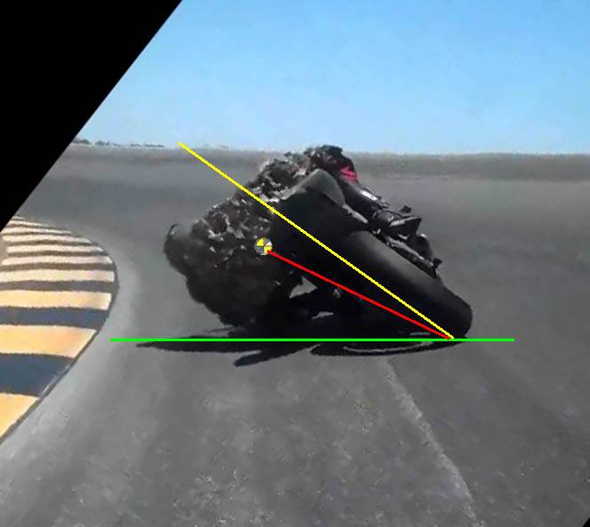

berkeman said:
For sure not the high speed banked turns like Daytona. I've read that the g-forces in those banked turns are high enough that the riders have to rest their helmets on a small pad on the tank, because they cannot hold their heads up against those strong g-forces. Yikes!
This cannot be strictly true. The sideways component of the force is of the order of 1.5 g, because it is limited by the friction of the tyres on the road. See https://www.f1technical.net/forum/viewtopic.php?t=20627 for data for F1. The support would make it a lot more comfortable and less tiring on the neck muscles.
  • #67
Did you take the banking into account? That is what makes the difference...
  • #68
Short answer: not correctly! Long answer leaves me skeptical for a different reason.
For a car, in the frame where the road is horizontal, you can think of the component of the centrifugal force that is perpendicular to the road as being an increment k * g to gravity so g is replaced by g * (1 + k), and forces are scaled up with this pseudogravity in a fictitious frame where the road is horizontal.
So sideways acceleration experienced by the head of a car driver can be as high as g * (1 + k) * mu, where mu is the coefficient of friction. This is definitely relevant to neck strain for car drivers on banked tracks.
But for a bike, the vertical axis of the bike needs to be aligned with the total acceleration in a frame of reference that is rigidly attached to the bike. Otherwise it falls over - it only has stability in one direction, not two like the car. So the additional force is solely in the vertical axis of the bike's frame of reference (the vertical direction of its frame). My first thought was that this mean no lateral neck strain, but the rider's head is pointing forwards, so his head is being pulled forwards from his point of view, and is subject to that enhanced gravity, g * (1 + k).
I really can't see where the rider can rest his head (see image), so I think he just has to build his neck muscles if this is a problem.
Don't forget that there's actually two forces on cornering bike. Downwards gravity and lateral centripetal force.
This is similar to if you hung an apple from rear-view mirror of car via string. String would have 1G when car goes in straight line. Under 1G of cornering, string would experience 2G total. Note that apple and string are no longer vertical, but hanging at 45-degrees, aiming towards outside of turn.
Now, hang that same apple from bike's... rear-view mirror. It too would have 1G of load when bike goes in straight line. Under 1G of cornering, string would experience 2G of load. This is supported by monitoring suspension-travel and under steady-state cornering of +1G, suspension-compression is much higher than during upright-riding. On many street-bikes, suspension is completely compressed and locked at full-travel. Thus street-bikes taken to track must have upgraded suspension with much stiffer springs.
  • #71
Yes, but you can combine gravity and centrifugal force (the fictitious force in the non-intertial frame of reference is the relevant one), as I did earlier. A consequence is that the angle of the road changes.
For a bike, this force is along the line between the tyre's contact with the road and the centre of gravity - roughly the line on the tyre in your diagram. This is necessary (given minor simplifying approximations) for stability in the frame that moves with the frame of the bike (excuse pun).
Friction in this context is a complex summary of the phenomenon of a moving tyre moving along a road with a resultant force acting on it. It retains an easily understood meaning: the tangent of the angle at which a bike can tilt is the same as this quantity if the centre of mass is kept in line with the tyre. It determines the point at which a tyre slides, based on the relationship between the two components of force (perpendicular to the road and parallel to it).
(I am ignoring small corrections such as that due to the rather small angle between the planes of the two tyres).

  • #73
A more familiar model to understand this is to imagine you're standing upright and someone slides sideways into your foot. Obviously they'd kick your feet out from under you and you'd fall over them.
But... what if you saw them coming? You can lean away from them at certain angle and not fall over when hit. As they impacted your foot, your entire body (if rigid and leaning away) would experience more than its regular 1G of force. Your head, even though not being impacted directly by sliding person, would be accelerated from its resting position and experience more than 1G. Obviously if they hit you at 10-m/sec and had enough energy to accelerate you to 10-m/sec in 1-sec, you would have to lean away at 45-degree angle and your head would experience 2G.
  • #74
Do you accept the point that if you pick your frame moving with the bike, so that the plane through the points of contact and the centre of gravity is considered as "vertical", then in this frame, the artificial centrifugal force (which results from the fact that the frame is rotating) and the gravity add to give a single perceived force in this "vertical line"?
The reason this viewpoint is useful is it is close to what the rider experiences. They experience something very close to an increased gravitational force which stays in the same direction relative to them and the ground becomes steeply sloping to the side. The effect of banking is to cancel out this slope in the ground. This is modified slightly by the choice of riders to shift their centre of gravity to the side, which means the tilt of the bike is lower (as the plane between the centre of gravity and the contact points is at an angle to the centre plane of the bike) . As far as I can see, this choice does not make it possible to go faster, as long as the tyre works over the full range of angles, which it should. It would be interesting to study whether riders really get any physical advantage out of changing their position on the bike, or whether (surprisingly) it just feels better.
Here I implicitly assume the rider is moving in a constant circle at a constant speed, but it is a very useful approximation.
  • #75
Yes, that model works, but rider still experiences 2G of forces. Banking only cancels out lean-angle, but it doesn't cancels out cornering forces. While you may be able to take 1G corner without leaning, there is still 1G of gravity and 1G of cornering. Just happens that cornering-forces are in-line with bike; it's pushing up on tyre instead of sideways on it. In cases of Wall-of-Death, there can be unlimited "cornering" traction since there's no leaning whatsoever.
This is especially apparent on 2-wheel vehicles that don't have as high cornering forces as motorcycles... say bicycles on velodrome. These are banked at either 20 or 30-degrees depending upon tightness of curve. At tighter 0.25km velodromes such as Hellyer Park or Encino, you really can feel the extra G-forces on your neck. On 0.33km velodromes like Cal State Dominguez Hills, curve isn't as tight, so less G-forces, even though bike still stays straight & upright relative to track surface.
There is an advantage when you change angle between effective CoG and contact patch. It allows for higher cornering forces with less lean angle and you don't run off edge of tyre. There IS an upper limit for lean-angles where you WILL roll off and crash. None of this idealistic "assuming unlimited traction" stuff not connected to reality.
This is where testing part of scientific process comes into play to verify hypotheses. Numerous real-world experiments have been conducted to verify:
1. there is not unlimited traction on tyres
2. there is a lean-angle limit beyond which you'll roll off edge of tyre and crash
3. when at this lean-angle limit, separating body & bike to maintain lean-angle, yet increase angle between effective CoG and contact-patch DOES allow for faster cornering without crashing.
This is typically what racers do in practice. They go faster and faster each lap and typically stay in-line with bike at lower-speeds. As you get up to lean-limit, you can feel bike starting to slide. Next laps around, you keep lean-angle, but hang off more. Suddenly, bike doesn't slide anymore. Then laps after that, you can continue with increasing speeds gradually again.
  • #76
You agree the 2g ( (1+k)*g in my post), as measured by an accelerometer on the rider say, is near enough along your blue line (presuming that goes through the centre of gravity).
  • #77
The 2G of force is inline with effective CoG and contact patch regardless of where rider's spine is located. In this example, it's in between spine of rider and axis of bike.
  • #78
Yes, I made my post more precise as you were posting! The reason for referencing the rider's anatomy was that back somewhere in this discussion we were discussing a claim that a rider had to rest their head on something.
The tilt of the rider's head in your penultimate photo makes some of this force to the rider's left, but not enough to be a problem, IMO. I think that the reason riders tilt their heads this way is it makes the ground look more horizontal and easier to mentally process.
