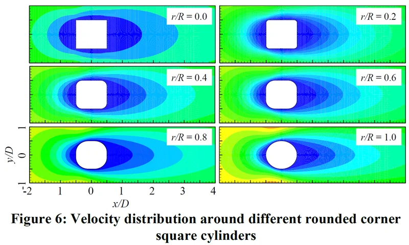

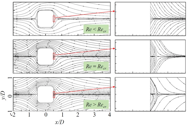

It's not difficult to find technical papers online that analyze 2D laminar flow around a rectangular cylinder. Here's one example picked more or less at random: Effect of Corner Curvature of Square Cylinder on Flow Transition and Heat Transfer
This paper computes and compares the flow patterns around squares for various Reynolds numbers and degrees of corner-rounding:
It also displays the magnitude of the flow velocity (flow speed) for different roundings:
Note that without exception the flow speed is higher (yellow & green) on the left where the flow enters and it's lower (blue) near the cylinder surfaces. So evidently it's not true that the flow "speeds up" as it encounters the front surface and proceeds to flow "radially" (vertically) there.
Added comment: Actually it is true that the flow speed is zero at the front stagnation point and then accelerates as it moves up or down toward the front corners (i.e., the iso-speed contours get closer together there). It's just that the flow never speeds up enough to equal the incoming flow at the left. That said, the highest value of this sub-incoming speed does occur at the front corners, so one of those corners is the best place to locate a turbine if you can't otherwise raise it directly into the higher-speed free-flowing region.
If this paper is correct, then the company is lying from the very beginning. The simulation shown in their videos are quite opposite to the findings of this research. And, as per this research, wind turbines can perform better a little higher point instead of the edge of the building.

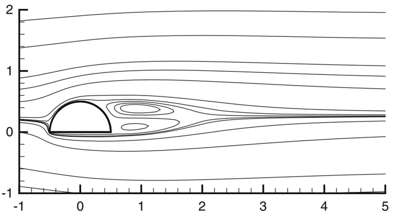

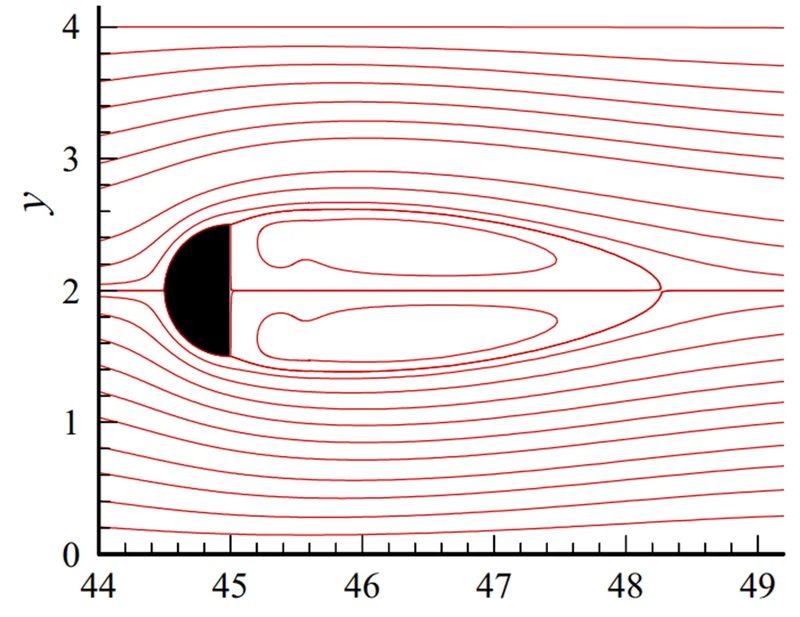

I am curious to see (and know) the outcome of this research if it's a half circle.
How is the "half-circle" oriented relative to the flow? Like:
or
or some other way?
