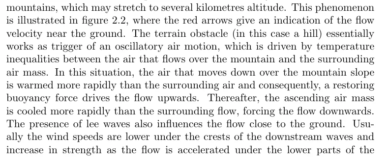

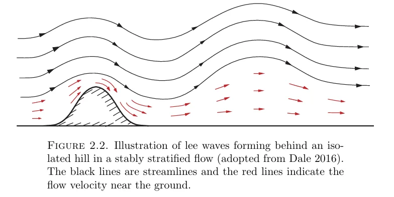

This discussion interested me the most.
This sounds like a gravity wave being set up close to the ground due to the hill.
https://en.wikipedia.org/wiki/Gravity_wave
