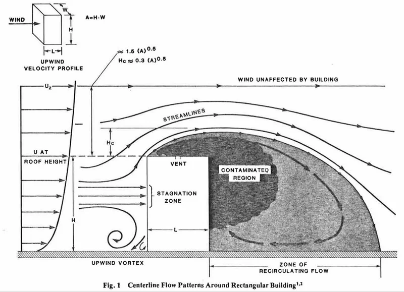

Is this your understanding if flow around a house, building, mostly low rise?
The reference given in the post 17 shows that flow around buildings, especially high rise downtown areas, can have complicated air movement patterns.
The upwind velocity U profile need not be that as shown in the figure below, especially if other buildings, or obstacles are in the vicinity. The U shown for the free stream is modelled as either an exponential or as a power function. At ground level, the U velocity is zero, producing the swirl under the stagnation zone. The dead zone is evident on the lee side of the building. ( Note the similarity to an idling car and carbon monoxide poisoning, where the noxious gas can enter the passenger compartment even if the exhaust is exiting at the rear ). ( And snowbank overhang extensions ).
Since the streamlines compress over the building ( and sides as well ), a velocity increase does occur.
It would seem the greatest velocity amplification occurs not at the actual edge but is a function of height and distance from the edge, surpassing Uroof_height, and possibly surpassing Uz under particular conditions.

It does seem clear from the diagrams @renormalize put in post #27, that the leading corners squeeze the streamlines together. That indicates an increased velocity.

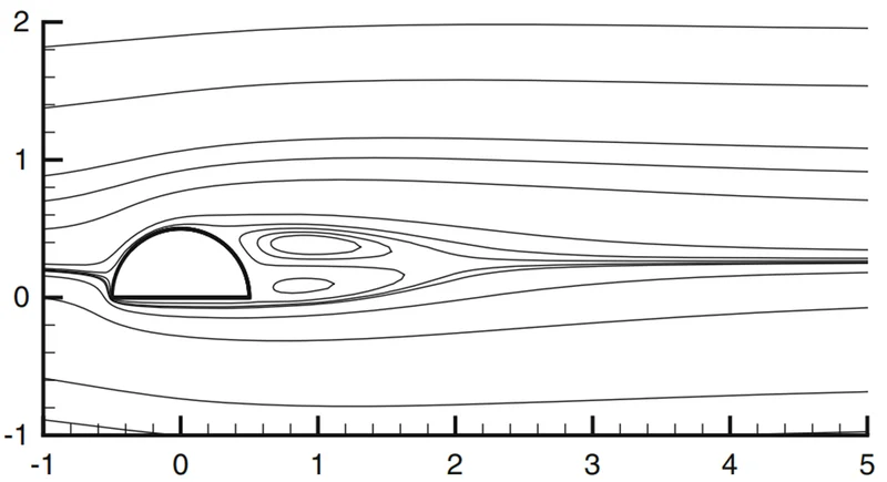

The diagrams that @renormalize included in post #27 seems to indicate that the velocity can be higher than the freestream velocity. The streamlines appear closer together at the leading corners of the obstruction than they were in the freestream.
I don't think that's the right interpretation. The flow-speed plots in fig. 6 of my post #26 show lower speeds (blue) everywhere around the building compared to the higher incoming freestream speed (yellow/green). But what you can say is this: if you have a turbine of finite aperture-width ##w##, placing it at the corners is better because it will capture a higher average flow speed (since the streamlines are more closely spaced there), compared to putting it nearer the stagnation point on the front wall. But in neither location will those average speeds be as high as the freestream speed. Obstacles always diminish nearby flow speeds to below that of the unperturbed freestream.
Sorry. I stand corrected. I was thinking about incompressible fluid flow. Thanks.

Those colors don't make any sense to me, given the streamline compression. & @256bits here's what AHRAE Fundamentals says (I'm trying to access the digital version or I'll scan my book):
"Flow accelerates as the streamlines compress over the roof and decelerates as they spread downward over the wake on the downwind side of the building."
"For an isolated high-rise building...high wind speed at pedestrian level can be caused by.... the corner streams."
I interpret both of these to be saying higher than freestream.
Note, Post #27 is showing flow around the sides of a long cylinder, not over the top of a building low to the ground (more like the second scenario than the first in the ASHRAE quotes. Note also, as you make your "cylinder" more aerodynamic it will start looking like a wing, where you certainly do get flow speeds above freestream.
The wikipedia article, for what it's worth, has images of flow around a cylinder showing velocity vectors with magnitude based on arrow size:
