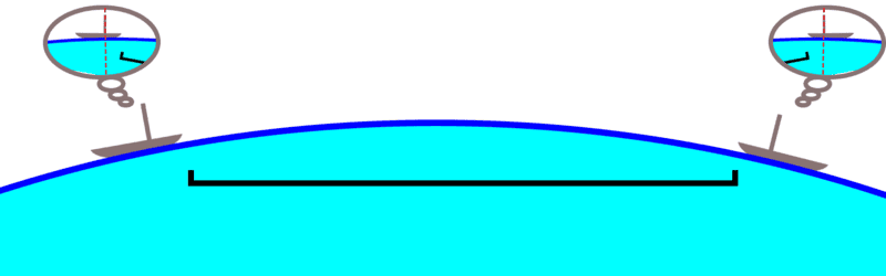

Usually I think pictures are worth a 1,000 words. But here I think words might do a better job. It’s agreeable, right, that because the earth is a sphere, that even if we used a small wire cheese cutter to cut a “slice” off of the surface of the ocean, it would be incredibly thin but it would be “dome shaped”, an invariable trait of spheres.
The “pan” simply replicates this on a larger scale. The water over the center of a pan will be deeper as shown in Dave’s drawing, just like the “tallest” part of that “dome” will be the “middle”.
Then draw the picture I describe.
Clearly not since the conclusion you have reached obviously contradicts reality.
Water flow has nothing to do with depth, and no, "deepest" and "tallest" are not the same thing.
You seem to be actively avoiding the correct answer. Last chance. Post the diagram I asked for or directly answer the questions that followed or I will lock the thread.

Your first diagram, with ships, the pan with a uniform rim and the curvature of the earth is 100% what I would have drawn, except I might have extended the rim to be flush with with the surface.
I can’t pass a test of generating a diagram on my iPhone, and that’s why I was glad that you did. If the conversation must end because I can’t draw diagrams on my phone, even though it would be the same diagram that you did, then I suppose it is my loss for not being more technically adept, and if it gets locked, I still appreciate the input.

I can answer the question under your edit. If we had a pan that was 250 miles wide, for simplicity, then 100 of these pans would touch each other, along the equator.
Each pan would represent 1/100 of 360 degrees, or 3.6 degrees. There is a trig function to determine the height of a line that extends 250 miles at 3.6 degrees, then cut it in half, because half of the dome is going back down.
It’s also doable by right triangle computation.
  • #43
Here you're not just saying you can't draw diagrams, you're saying that even if you could you wouldn't draw the diagram I asked for(edit: we cross posted and the diagram you described in your last post is also wrong/not what i asked for). Nor are you answering the questions I asked. You aren't trying to move towards the answer, you're actively avoiding it. That's why the thread is now locked.
For the record, the answers to the questions I asked are:
-The elevation of the water at the edges and center of the pan are the same: zero meters above sea level (or 6378km from the center of Earth).
-If you raise the elevation of the pan by 1m, the elevations at sides and edges are now 1m.
So the water at the center of the pan is not "higher" than at the sides.
Caveat on this answer that it only works for relatively small pans of a few km since beyond that the sides aren't rising directly vertically. But you couldn't have a flat bottom with a much larger "pan" anyway (like an ocean basin).
There's another caveat/catch as the altitude gets large, but I'm skipping that.
[edit] Thread will remain locked for the reasons described above.
