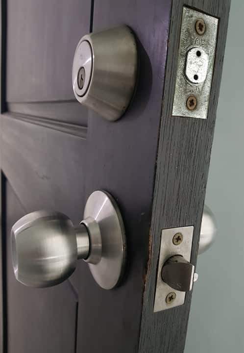

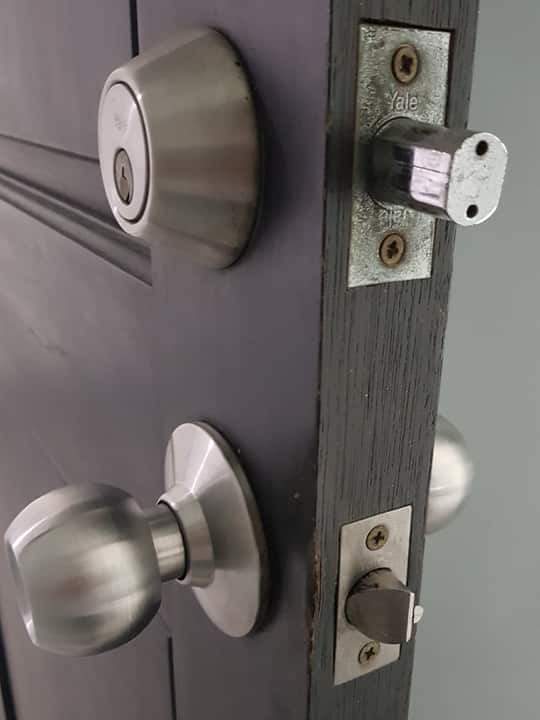

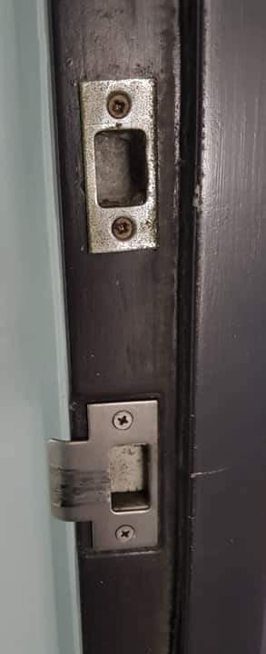

I rented a unit at the 32th floor for 6 months. The door has only 2 locks. The top has a double lock. The bottom is a normal door lock.
Now imagine a drunkard or robber that would just kick the door from outside. It is enough to break the lock as it's secure on just wooden frame.
Do you know of any mechanical device that you can put on the inside (kind of shim put at bottom) so even if the drunkard kick it many times. The door is still secured? The portable device has to be something that doesn't require drilling of the concrete (as I just rented the unit).

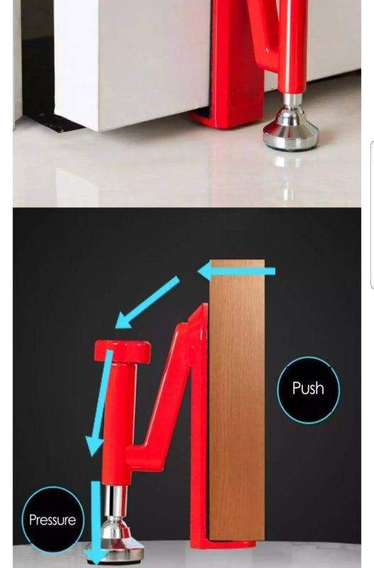

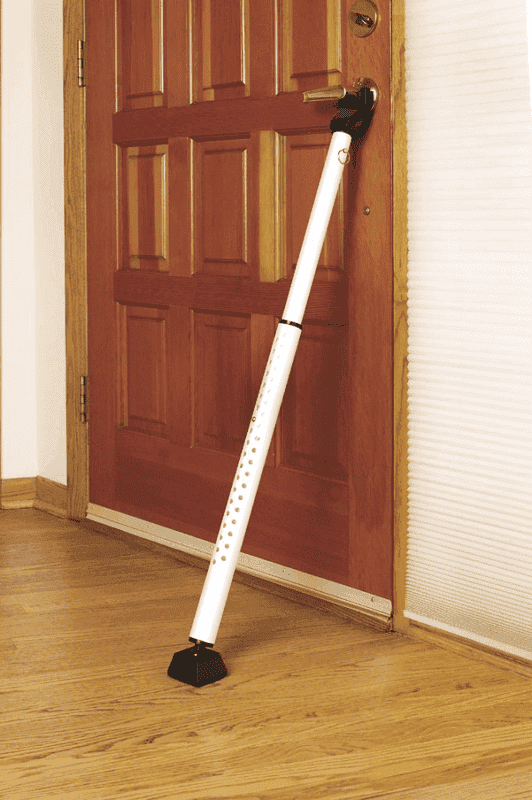

Get two of these. Put one at the top and one at the bottom of the door. He will need to tear out the door frame to get in. Simple but safe.
Are the screw parts on the door or floor? How is it supposed to stop the door from opening mechanically?
... it's secure on just wooden frame.
Maybe worth a second checking on that. I've seen many cost-effective things already, but locks usually expected to be 'locked' into the wall and the frame is just a decoration.

Look up "security bar door jammer".
No screws at all, bottom works based on friction.
I have been using one of those, not sure if a drunk guy has tested it yet, though. :smile:
Really feel sorry for that guy if he tries when we are out and the bar is not installed, he will not find much inside my apartment.
For any better deterrent, you must use screws.

This device requires two screws to be placed in the door frame in the gap between the door edge and the frame. then the flap is raised up and rotated 90 degrees and dropped in place to block the door from opening. Very effective.

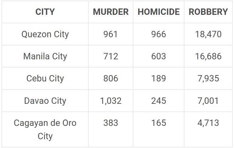

Quezon City.
https://www.rappler.com/nation/127860-quezon-city-pnp-highest-index-crime

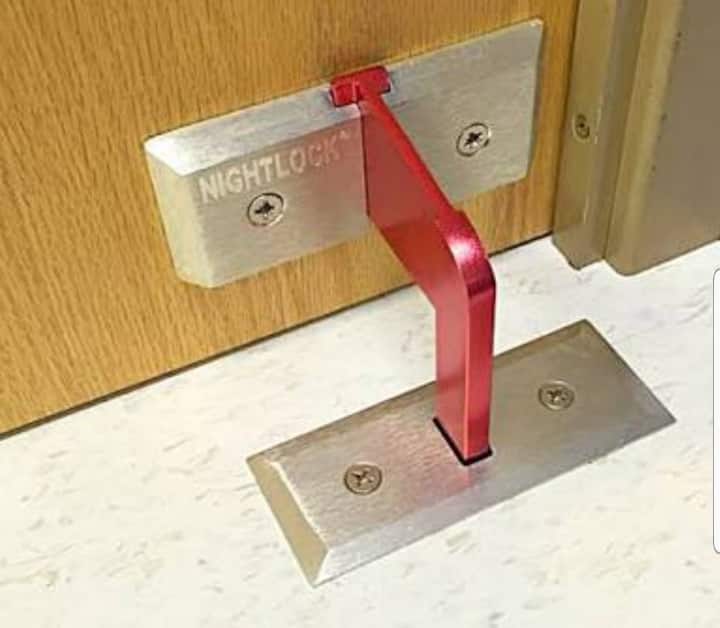

The above works because it's pushing against the fixed hole in the floor. What is yours pushing against? Please show some link how it works. I need to buy two different kinds of protection to be sure the door is not kickable without making loud noises enough to call 911.

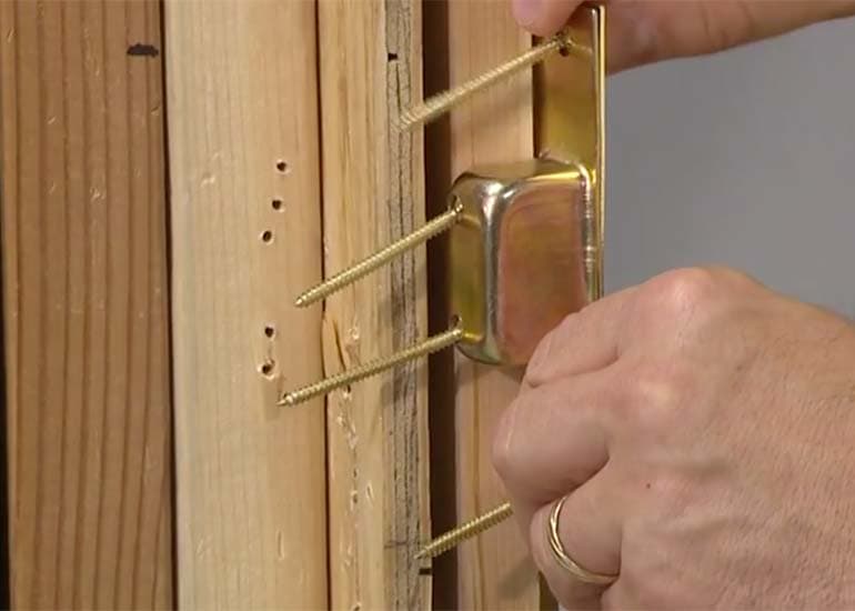

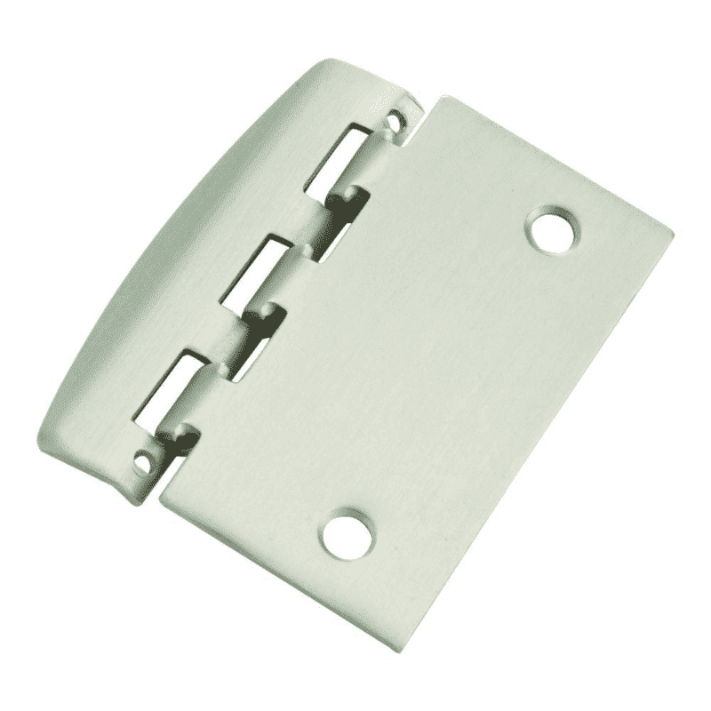

That door flip lock should work, and you could fill in the screw holes if you leave the apartment.
But I would not recommend a door with a big window like in the video, nor a flimsy door that a drunk could put his foot through.

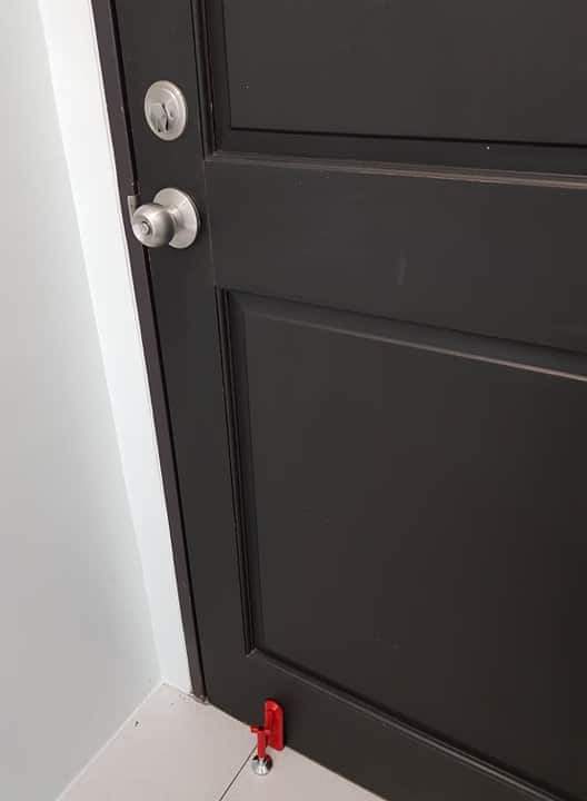

Im stll trying to find source for it.
So far this is the only one i found at china via lazada.
Will it work? Based on similar config in your experience?
chirhone said:
... Will it work? Based on similar config in your experience?
That device will not prevent your seriously determined guy (reaching the 32th floor, stepping 10 meters backward and running very fast onto the door) to break the two regular locks, because the door is flexible and those are located higher, by the area of impact.

Another option is to replace the lock plate for the dead bolt with a more secure option like this:
It's sturdier, and the longer screws reach all the way into the wall stud.

You mention that the door frame is just light-weight wood set into a hole in the concrete wall. You want to secure the door with better locks.
With that construction, you have the same problem with the hinges breaking out the door frame.
Also, if you floor-mount a stop/lock as in posts #12 or #15, that still leaves the existing locks and upper hinges vulnerable. The floor-mount stop/lock will just be a pivot point.

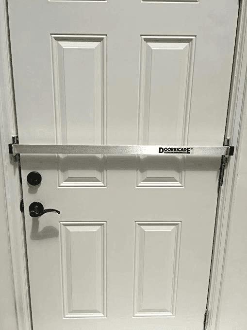

For real security at least three, preferably four, restraints are needed: a high and low placement on the door edge with the locks, and at least one on the edge with the hinges.
The approach in post #2 is probably the easiest and is quite effective. That bar from the doorknob to the floor is adjustable in overall length, either by threads cut into the two telescoping pieces, or steel pin(s) inserted in holes to fix the length. They work well on solid floors, not so well on carpets. To lock, you just wedge them in by kicking them in place.
Using another of those bars at the hinged edge would make for rather good security. Since there is no doorknob at that door edge, screw a length of good-sized angle iron to the door horizontally across the solid part of the door. Use several large diameter screws. Several large screws because the inward force by an attacker is translated to an upward force that trys to rotate the angle iron upward, pulling the screws out.
Of course the landlord will want to charge you for a new door when you move out... unless you fill the holes and do a decent paint job.
The above will keep the door closed but that won't stop someone from kicking in the lower door panel. You could attach a steel plate over the lower half of the door... if you don't mind the place looking like a prison.
Or just replace the whole thing with a metal door with a separate heavy bar across it. The bar would drop into sturdy hooks firmly attached to the concrete wall on either side of the door. That would likely cost several months rent, and a VERY mad landlord though! :oldwink:

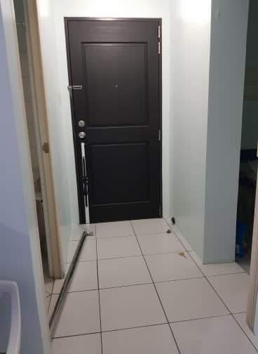

After much considerations, i ordered the most expensive Buddybar Door Bar to avoid breaks of the bar parts. Its strong enough to lift a car (do not try this at home).
But the bar has tendency to slip in some floors. I still ordered it to try. If it slips. Ill get this.
This is about 135 lbs actually built i saw in net. I heard it has good staying behavior. How do you compute what must be its weight so the door bar won't slip?
Th closer to vertical the bar is set, the less likely it is to slip... up to a point. If actually vertical it won't be of much use at all. The optimum angle depends on the coefficient of friction between the floor and the material of the foot of the bar. Polished concrete and tile floors are the most problematic, with carpets a close second. Best seem to be wood or vinyl floors, something with decent friction and a small amount of compressibility. That suggests a block of wood under the foot of the bar may help on hard flooring, but I haven't tried it.

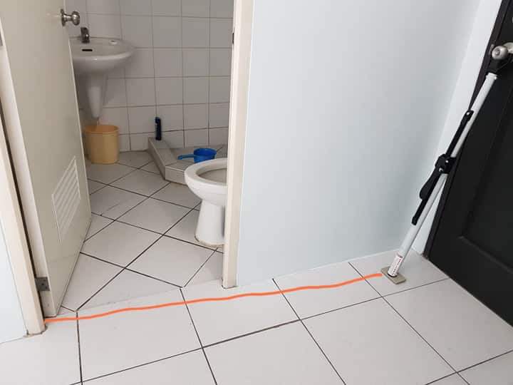

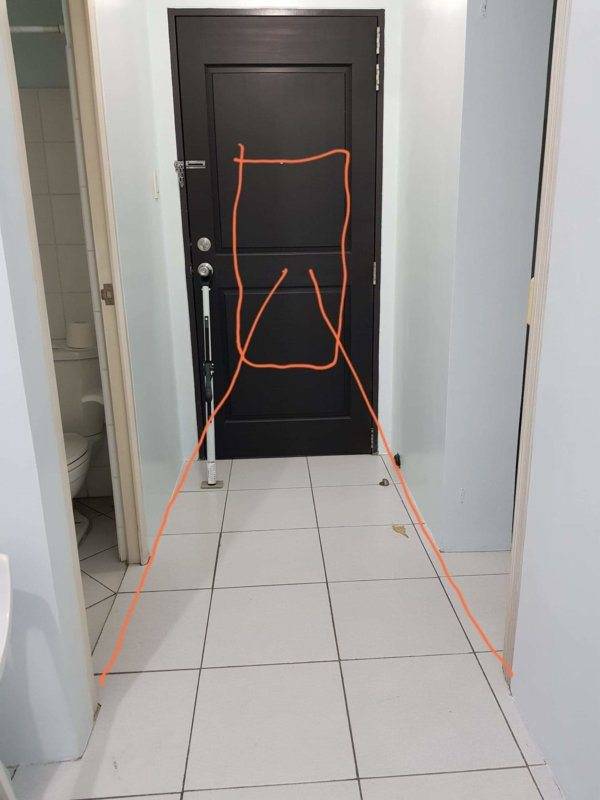

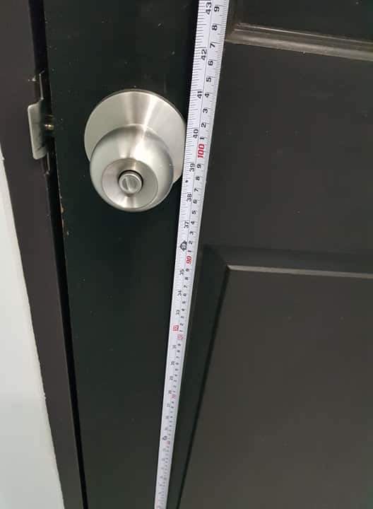

The distance between my knob and floor is about 39 inches. Whats yours and the common in the US?
Don't know about the 'common', where I live the measured interior knob height is 35½-36 in. and the exterior is 39½.
Why is it not the same height exterior and interior when it is made of the same lock (bottom of picture)??
This is also why the door flips won't work. Because imagine the door frame lock holes were shred as the door is kicked open. All the door flips would just go off along with the main lock holes. Objections? Affirmations? This is why the door bar along with a heavy object fixed is more secured (I think).

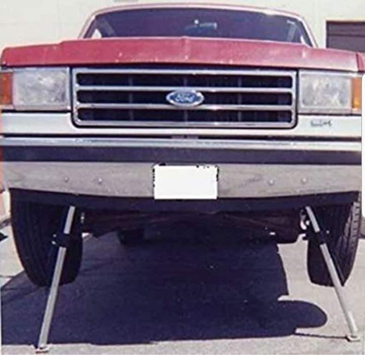

Once I bought a long 2"x4" board cut it to fit between the door and the opposite wall. Simply lay it on the floor no one can kick the door in. Door locks only keep out honest people. Thief with, ax, chain saw, pry bar, 10 lb hammer will get in.
