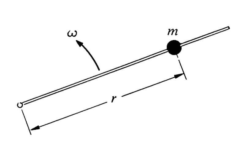

A particle of mass m is free to slide on a thin rod. The rod rotates in a plane about one end at constant angular velocity ##\omega##. Show that the motion is given by ##r=Ae^{-\gamma t}+Be^{+\gamma t}##, where ##\gamma## is a constant which you must find and A and B are arbitrary constants. Neglect gravity.
Show that for a particular choice of initial conditions [that is, r(t=0) and v(t=0)], it is possible to obtain a solution such that r decreases continually in time, but that for any other choice r will eventually increase. (Exclude cases where the bead hits the origin.)
I guess I have to use polar coordinates. In polar coordinates,
[tex]\textbf{a}=(\ddot{r}-r\dot{\theta}^2)\hat{r}+(r\ddot{\theta}+2\dot{r}\dot{\theta}) \hat{ \theta }[/tex]
Here, ##a=0## and ##\ddot{\theta}=0##. Hence
[tex]0=(\ddot{r}-r\omega^2)\hat{r}+2\dot{r}\omega\hat{\theta}[/tex]
This gives,
##\ddot{r}-r\omega^2=0## and ##2\dot{r}\omega=0##.
Solving the first equation gives a solution of the form presented by the question and I get ##\gamma=\sqrt{\omega}## but the second equation gives ##\dot{r}=0##. This doesn't look right. :confused:
Any help is appreciated. Thanks!

It says 'the particle is free to slide on the rod'. What direction is it free to move in? And what does that imply about the other direction?
It is free to move in the radial direction.
What is the other direction? Perpendicular to rod? :confused:
yeah. I'm sure you'll be like 'oh of course' when you realize why equation 2 is not equal to zero.
Actually, I still don't realize why second equation should not be zero. :rolleyes:
If it were zero, then what is keeping the particle constrained to move along the rod?

I meant that the force ##2m\dot{r}\omega## (coriolis force?) is balanced by the normal force exerted by the rod on the particle or bead.
voko said:
This is the frame in which the rod is stationary. It will have fictitious (inertial) forces. The frame rotates uniformly, so these forces are well known.
But even if you do not know them, these forces will have two components: along the rod and perpendicular to it. Do you care about the perpendicular component? Why? What about the parallel component?
The particle is constrained to move along the length of rod. The normal force balances the perpendicular component. The parallel component is responsible for the motion of particle along the rod.

Okay, let's not talk about the other reference frames and solve it in the inertial frame. I haven't yet studied the Coriolis force so I think it would confuse me more if I try to work on it using the rotating frame.
But how do I solve this in inertial frame now? Hmm...I think my acceleration vector is wrong. I did not take into account that the normal force also acts in the ##\hat{θ}## direction. Correct?
You wrote the acceleration vector correctly, but did not wrote the equation F=ma. If you write it, you need to include the normal force to the left-hand side. ehild

Normal force = ##mr\omega^2 ##? :confused:
I don't really understand where this discussion is heading. I asked about the wrong result produced but I don't think I am anywhere close to clearing my misconception. :(
Go back to the inertial frame. The particle can slide freely along the length of the rod. This means it is moving freely in the radial direction but clearly there is a constraint force acting on the particle in the tangential direction that is keeping it constrained to move along the length of the rod.
The normal force (N) in the tangential direction balances the force ##2m\dot{r}\omega##.
Equating forces in the tangential direction, ##N=2m\dot{r}\omega \Rightarrow \dot{r}=N/(2m\omega)##. But the acceleration vector I wrote down gives ##\dot{r}=0##. :(

For radial direction,
##F_r=ma_r \Rightarrow r\omega^2=\ddot{r}##. The solution of this differential is asked in the question.
For azimuthal direction,
##F_{\theta}=ma_{\theta} \Rightarrow N=2m\dot{r}\omega##. I am sorry if this wrong. Please have a look at my attempt on the other part of the given question.

This is correct! :)

It is OK now.

The initial conditions mean knowing r and v=dr/dt at t=0. You know the general solution of r(t). You also know that B has to be zero. What are r(0) and v(0) then?
