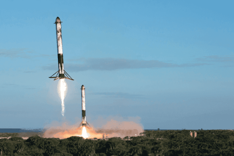

You mean kind of like these? :wink:
https://www.spaceforce.mil/Multimedia/Photos/igphoto/2002222258/

berkeman said:
Yes, like these, but there is a difference. SpaceX is carrying out a repair process for the engines of its rockets returning from space. As for this idea presented above, it dispenses with re-repair because basically the flames do not touch the nozzle of the rocket engine, and therefore it does not need to put insulating material again and check the missile and test it many times. before re-launch
